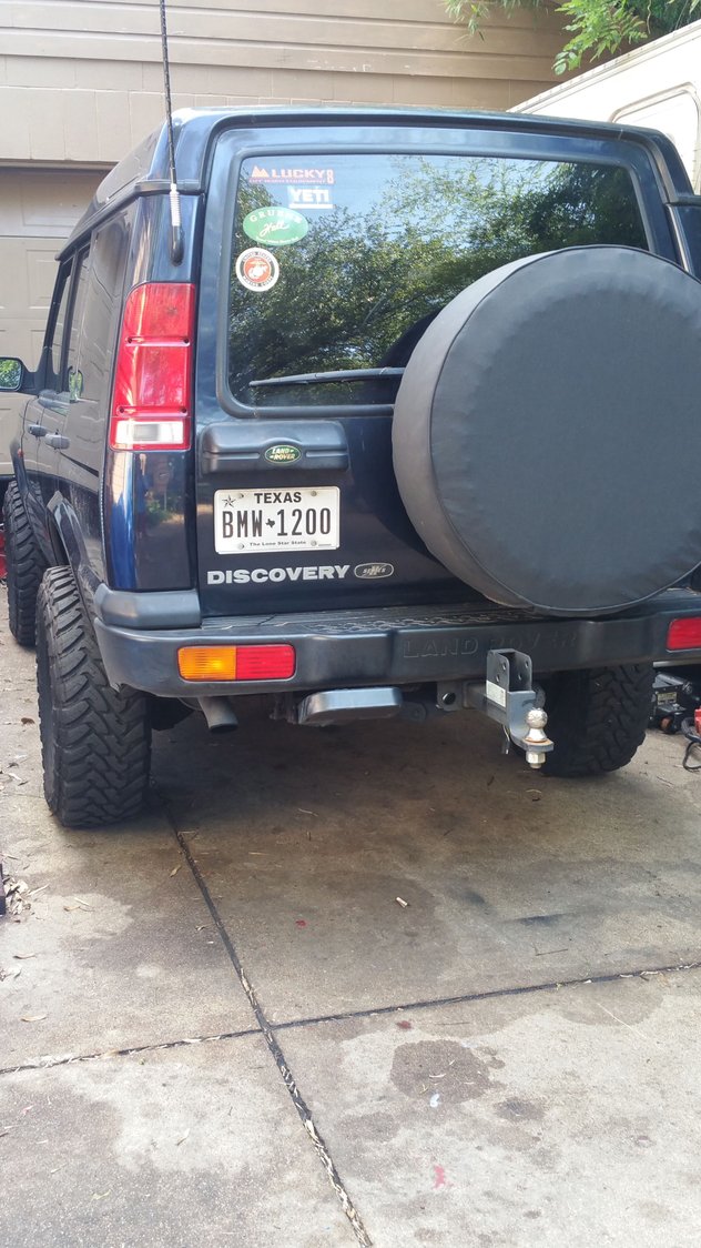

FWIW, here is what mine looks like from the back. Sticks out quite a bit. That's the issue at a partial turn combined with a bump.
I'm useless; that's the best picture of the "stance" I can find.

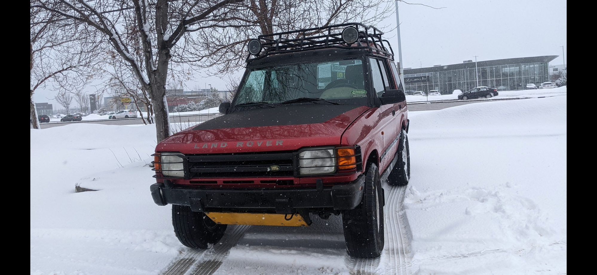

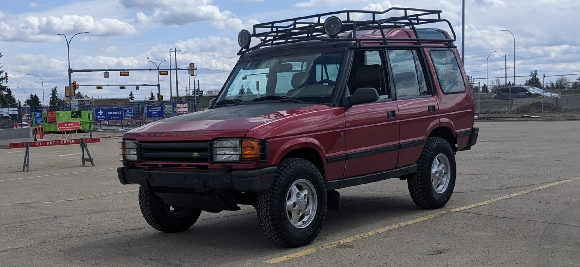

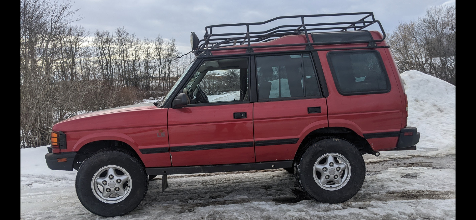

Had 265 on my D1, switched to 235/85 16 .
It has wheel spacers and a small 2" lift.
265 tires
235/85 16 tires, Nokian Outpost.
