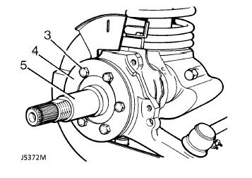

What bolts did you remove? One of #3 in this image? Those are the stub axle retaining bolts.
Was it leaking at the bottom of the stub axle? Or on the back side, at the bottom of the chrome swivel ball?
If the former then you'll probably need a stub axle gasket, or some Right Stuff, if the latter you'll need a new swivel ball seal, and swivel ball to axle housing gasket.
RTC2511 is the hub seal you want.
Old Jun 1, 2012 | 06:33 PM
AZlandy's Avatar
Joined: Feb 2012
Posts: 25
^ yes it was the bolt #3 in the pic. and it was leaking out of the chrome swivel ball as well, so i think its safe to say i need both gaskets . what do i use to replace the fluid that leaked out? and where do i put it back in?

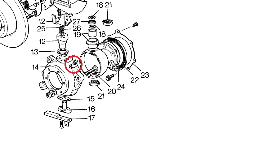

#6 is the swivel seal you need.
swivel.jpg?t=1254831683
I can't remember if the 96 has them, but the drain is circled in red
There's a filler plug about 1/2 way up the swivel housing. It's a 1/2" square.

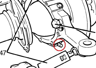

here is the fill:
For goodness sakes MAKE SURE YOU CAN GET THE FILL OPEN BEFORE YOU DRAIN IT.
Seems people are a bit sloppy these days with the advice. It pays to be thorough.
Good luck
