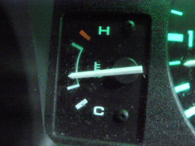

My temp sensor is malfunctioning again (it happened at URE in April). This leads me to think that it could be the temp sensor again or could it be the gauge? anyone know what to do?

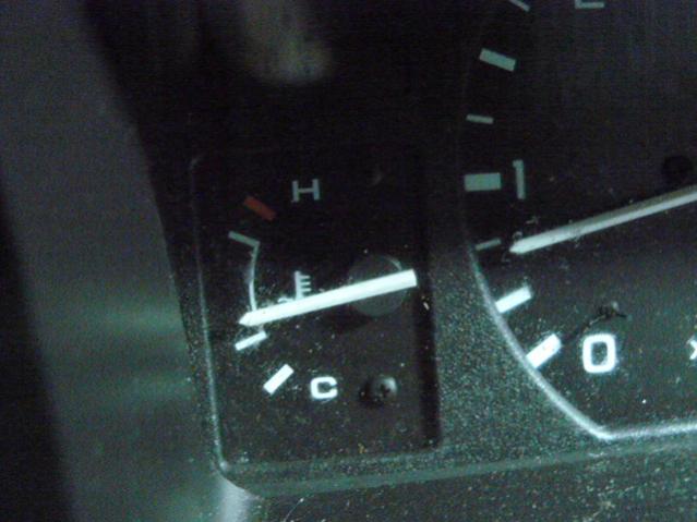

Which sensor - the two wire one that drives the ECU, or the single wire one that drives the guage? Who do ya trust???

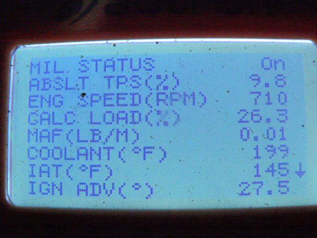

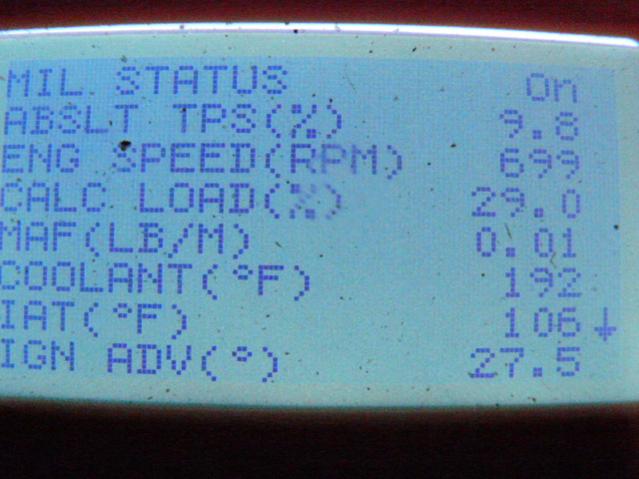

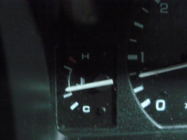

Let me show you what a scanner can tell you:
First photo - 163 degrees, warming up
Next - 180 degrees
Next - 192 degrees
Next - 199 degrees
So you can see that big change in temp can make little change on the guage. If you don't have, or can't use a scanner for data (not equipped), you can use an IR thermometer. See next post.

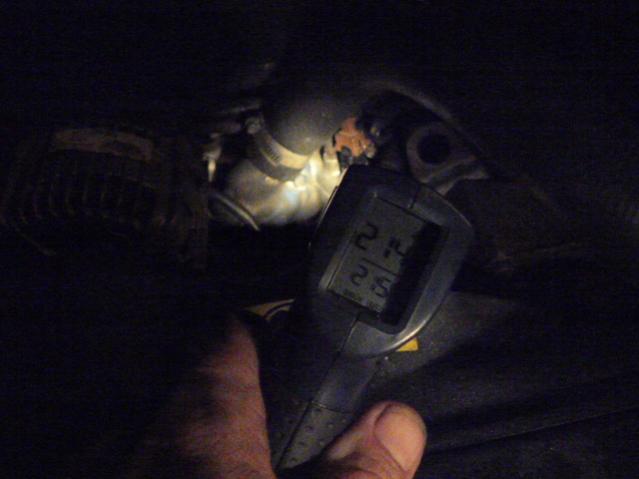

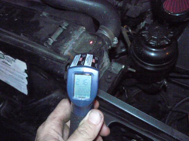

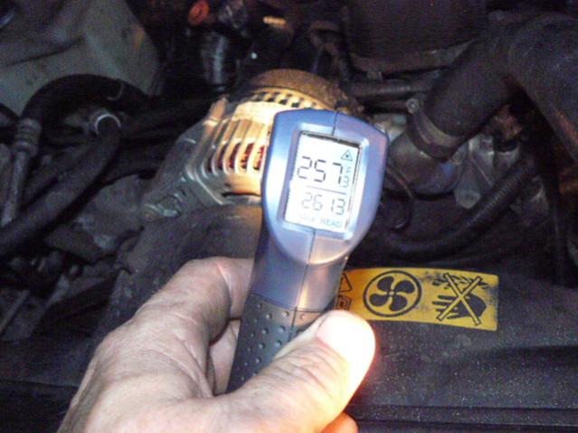

An IR thermometer can make readings. But it can also be fooled. It is not measuring just the spot of the laser dot. The "beam" spreads out like a flashlight.
Here's a photo of the alternator, too hot to touch; and the radiator just after the top hose enters. The top hose itself read 10 degrees cooler, the rubber acts like insulation, compared to the brass radiator.
I would like to make two points:
1. You can get strange readings depending on the measuring device used.
2. If your guage is deviating from the normal range that you have enjoyed for the last several months, there is the possibility that the truck is overheating. You should check by several tests and stop driving the truck in case the guage is right, and you are frying the engine.
What kind of guage readings are you getting?
