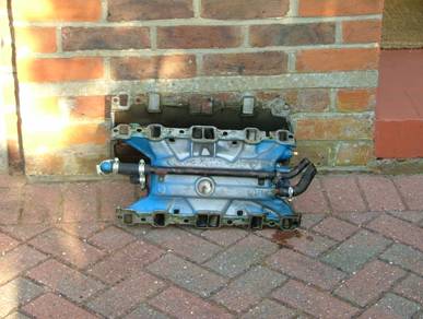

heres where everythings at after the weekend. i put on the "heavy duty" taller oil filter while i was in there taking things apart as well. expect to add an extra .5qt or so of oil if youre going that route. i think there were some questions in one of the oil filter threads on whether the heavy duty filter would fit with the glowshift adapter - and it does. with room to spare.
also turns out that coolant plug on this truck wasnt brass, it was steel, but no matter.
probably more pictures than needed, but who doesnt like looking at pictures :P

This looks great. Back when the engine was a whopping 3.5 liters, that fitting on the intake was part of the heater core system.
Attached Thumbnails thoughts on good location for coolant temp sensor?-image016.jpg
