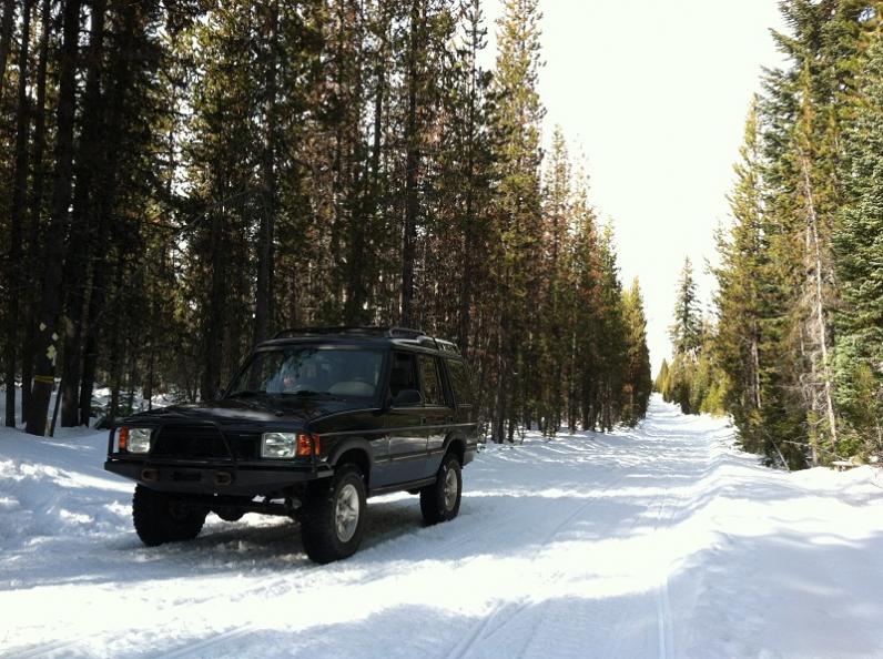

Old Feb 5, 2013 | 11:27 AM
EricTyrrell's Avatar
Joined: Sep 2011
Posts: 1,526
Likes: 18
From: Oregon
Originally Posted by fishEH
235/85/16 GY DuraTracs For The Win!
Yup.
