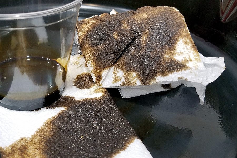

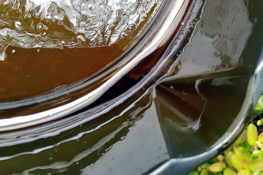

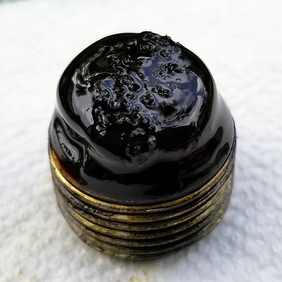

...thanks DiscoCam! I had already decided to drain-n-refill after a week, assuming that it would help cleaning and getting rid of more shavings and gunk inside the t-case; so bought 85W-140 for the refill, and went again for the Lucas brand (under $8 at AAP).
Crawled underneath my truck to start working; filler and drain plugs gave a bit of work to loosen up once more; filler one is kinda tricky to get to, since the brake drum gets in the way, and drain plug came out after using and extension on the wrench, for more leverage. No apparent signs of leakage was seen, although this past week rained cats and dogs here in Broward county (SoFla) as well, and truck had to go thru a lot of flooded streets, and I mean "FLOODED", so undercarriage had a nice bath!
Fluid drained came out very, very dark, and it was only a week of use! can't imagine after 30k miles! Viscosity was pretty much as it was when it went in though, maybe a bit thicker? Very little to none metal shavings or particles, so hopefully most of the big chunks came out on the previous drain. Did see a lot of "metal-dust", if you may; drain plug came out with nice amount of gunk, and what I can describe as very, very short hair-like metal, since it was hard to clean off the magnet (look at the pics).
I poured the old oil into a gallon jug, and what was left on the oil drain pan did feel more sediment-like, and it was like a two color liquid; a very dark black tone, and a dark chocolaty too (look at the pics).
I'm posting some pics so you can see how this second drain went, and receive any feedback as to if it would be advisable to do a third drain a week from now? would it help to get rid of more gunk and metal shavings? and get things cleaner in there, especially now that it will be running with a thicker oil?
I'll be looking for your inputs, thanks!

Wouldn't hurt to do another drain and refill before you get the 85w-140 in there. The heavier weight oil will help if you actually have excessive wear.
