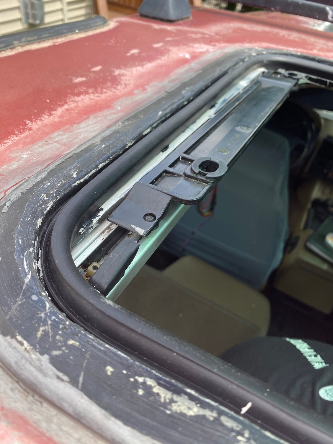

I bought my disco 1 from my brother about 2 years ago. Soon after purchasing I found both sunroofs leaked. I read on several of these forums to seal them, so I sealed both. Front sealed great- going on one year without leaks. The second, however, worked for a few months then started leaking again. I resealed, thinking maybe I’d done a bad job the first time, then replaced one of the buttons on the glass, sealed around the frame where the plastic and fiberglass meet in addition to where the glass and rubber seal meet. None of this worked. I checked the drain tubes and they are clear and no leaks, and the nipples on the trays the tubes hook into are in good order.
Finally I recently broke down and bought the Sunroof gasket from Lucky8 (EEQ500010) and installed it, but now the sunroof won’t sit properly/seal even after bolting the glass buttons in to the rails. I’d love for it to be something stupid I’m doing wrong, but I’m really struggling to figure this out.
Did I put the seal in wrong? Any other input or advice? I read the glass could be warped or maybe the rails are broken? I’m out of ideas.
