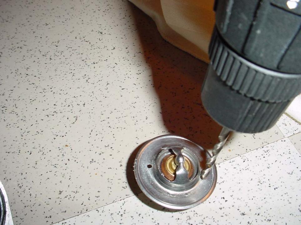

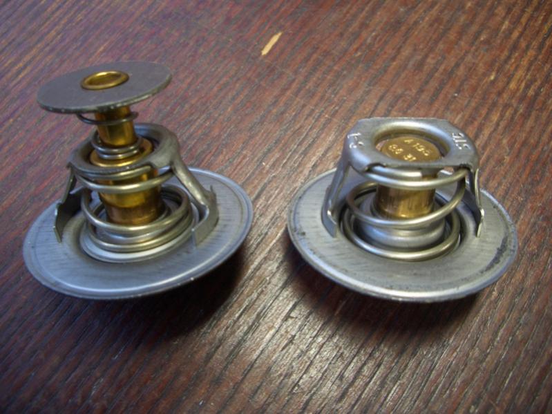

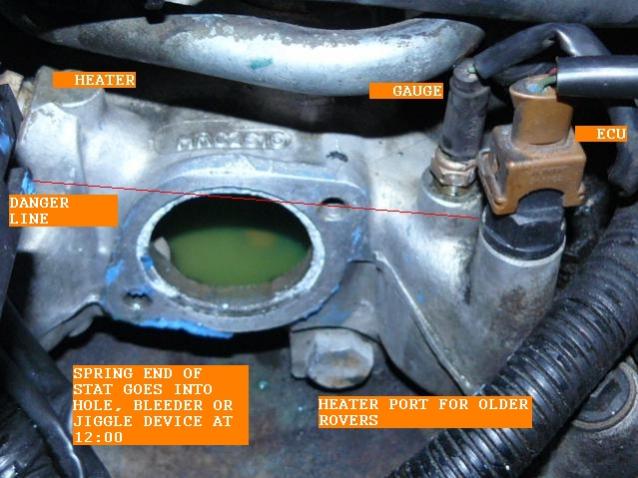

Goes in this hole, spring inside block. You knew that but noob # 23578 may not. Same stat fits like 3000 plus vehicles. IMHO if you drive in Atlanta traffic the 180F is a good choice. It will be made out of stainless and brass, like one on right. If it does not have a jiggle device in the rim you can drill a small hole. That goes at 12:00 position. The jiggle device or vent hole at 12:00 allows steam to pass by, and not form a pocket. If a pocket forms, the stat may stay closed too long and engine overheats. If you want to test just pop in a pan of water on the stove (with approval from SWMBO - I am only approved to wash pots, not operate them).
With the 180F stat my D1 pokes along at 178 - 183 on the secondary roads, and maybe up to 187 on the highway. Once in a while will bump into the 190s. Is that a safe temp? Has been for my KIA van, 180F just about always and 243K. In the old days the spec stat for the Buick Skylark was 180F. The 94 Defender manual in the RAVE shows a pix of a factory stat stamped for 82C, which would be 179F. The higher temps are used to comply with the clean air requirements, not make engines last longer.
