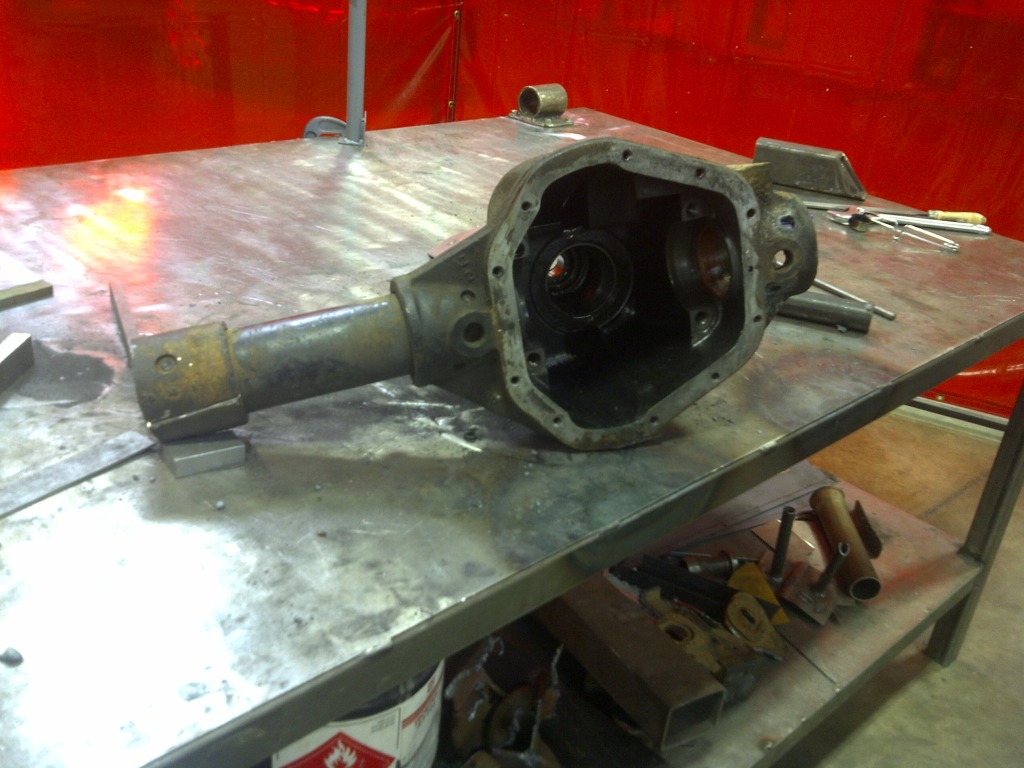

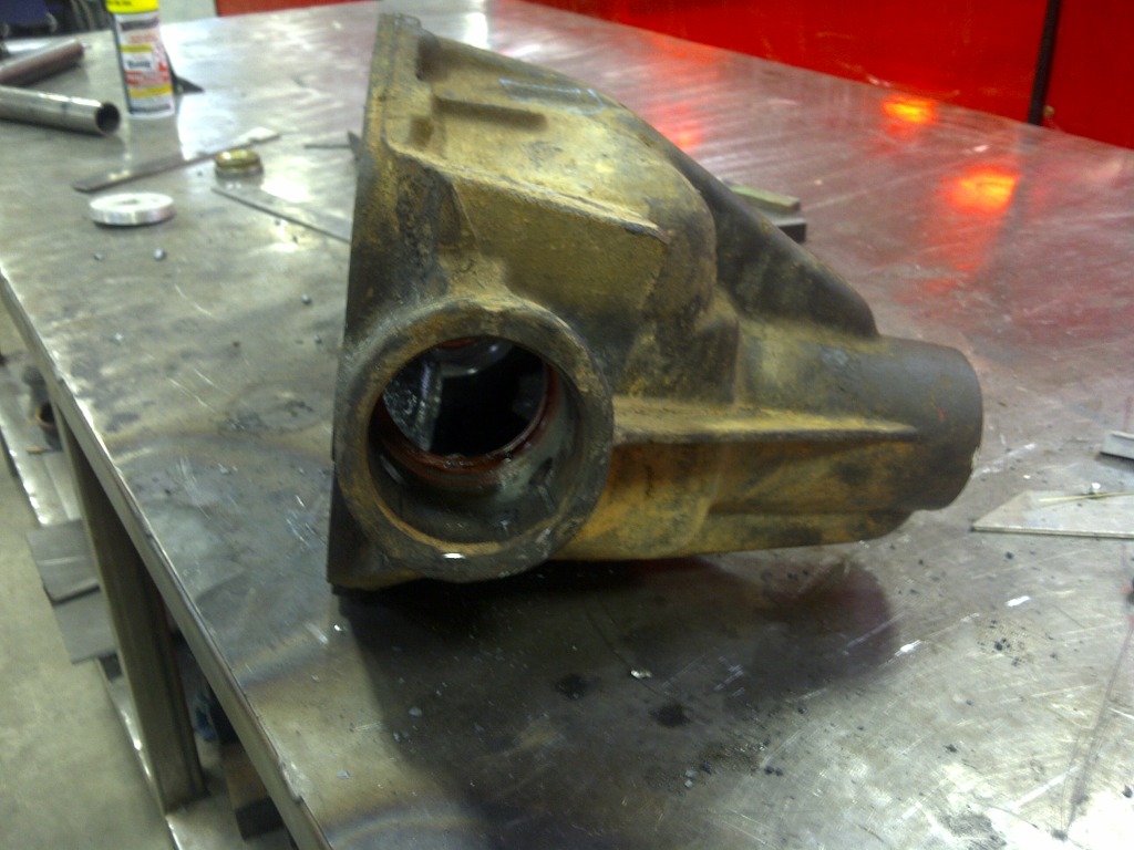

small update for today. I worked a bit on the front axle today and got the axle tube pressed out.
I had to cut the welds out first

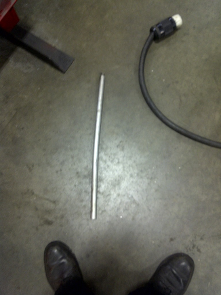

then I found out that solid aluminium rods don't work well to press and axle tube out with a 55 ton press (around 8-10 tons when it bent), but it did get it started

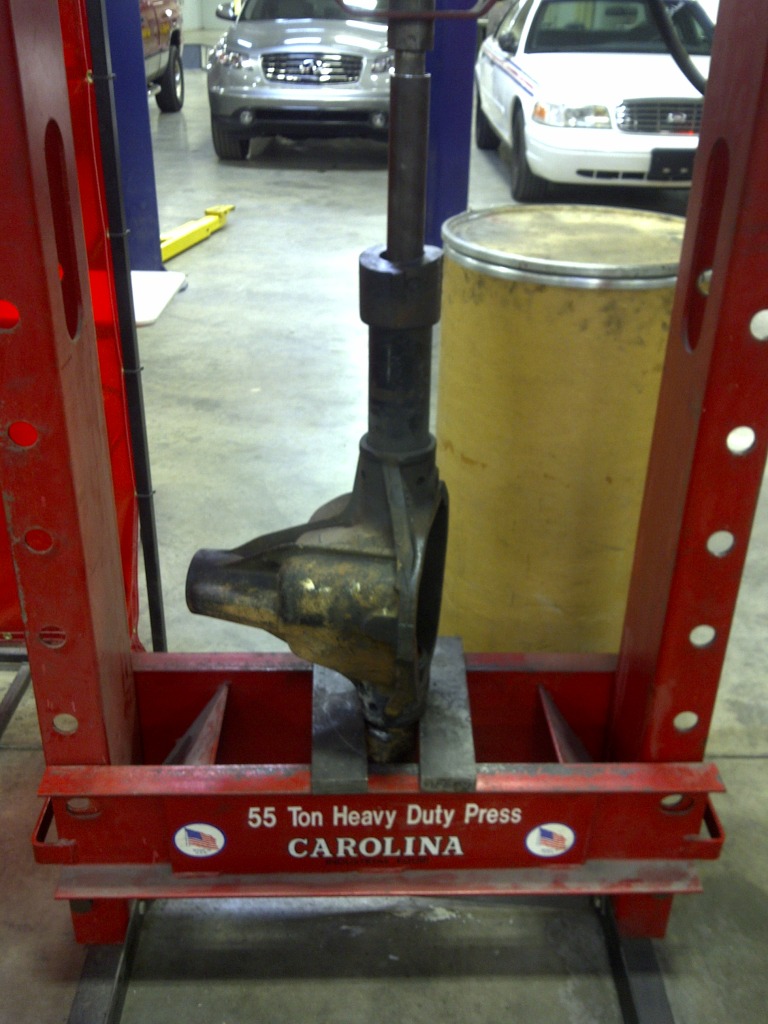

so, then i made a new press extension out of 1.75" DOM tube
and it worked, no more short tube!

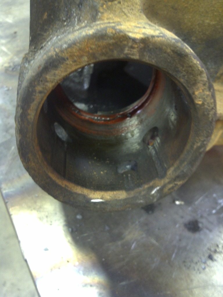

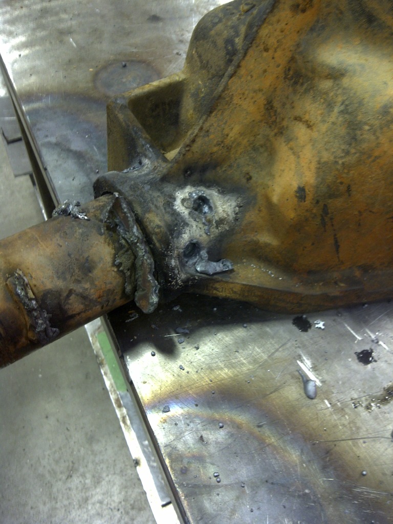

however, some weld did hang around and scratch the housing wall, but that shouldnt be a problem
