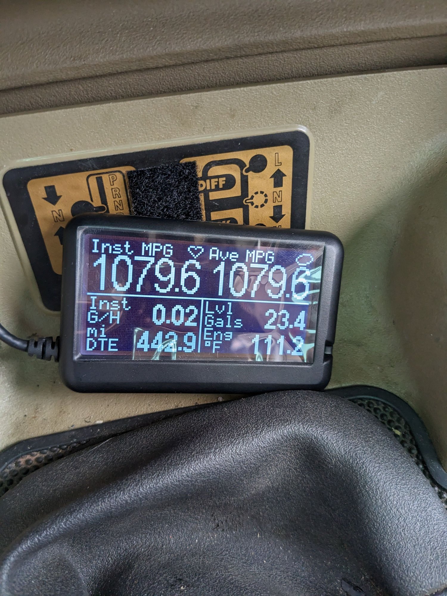

I was driving down the highway and lost power steering. This should have been an instant warning sign, but my previous vehicle didn't even have power steering and I knew my Disco had a leak there. I thought maybe a hose came undone or the leak had grown and since I was 5 minutes home.
I looked at my ultra gauge which gives temperature readings and I notice it started jumping up from 190, to 210, 215, 220. At 220 I turned the engine off and coasted to the side of the highway. The temp spiked at 230 for a second and started slowly going back down. When I looked at the temp gauge on the dash IT BARELY MOVED past half way let alone, no where near the "H".
Once I popped the hood I noticed my serpentine belt was off but there was no visible reason as to why it would have been thrown off. Since I always carry tools with me I got the belt rerouted and when I applied pressure to the tensioner the pulley disintegrated (see image below). There were no bearings on the inside.
​​​​​​Since I was 5 minutes away, I got a ride home, pulled off the tensioner pulley off of the parts Disco and was back on the road within 10 minutes once I got back. I went to the nearest auto parts store and was able to pick up a new tensioner pulley.
Long story short, I highly recommend the ultragauge or some way to monitor these older vehicles to keep them on the road longer.
I have no affiliation with the company and in all actuality, I am still working with them to fix an error I am having with MPG due to the MAF sensor reading being 2 decimal places off.

a new disco owner here and just got my ultra gauge last week. engine temp been hovering around 177 when driving around town and highways here in san diego.
question – what other readings do people normally look at/have on their home screen?

I always check O2 sensor voltage trends. If O2s are switching properly, that tells me the fuel system is pretty good. Any O2 stuck at a solid value tells me something is wrong.
Also check short and long term fuel trims. They can help diagnose vacuum leaks or bad injectors.
