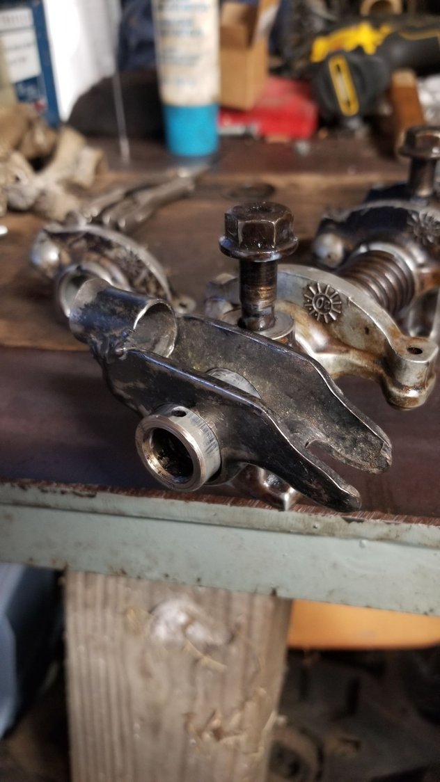

Several hours after I made the initial post, had a thought. Back in the late 80's - early 2000's I played with '86-'87 turbo Buicks. Since the Buick 215 is the grandfather of the LC2 (3.8, 231 V6) maybe the valve spring compressor I bought over 30 years ago would work.
It does. Just had to shave a little off the sides to pass the keepers and voilà, Bob's your uncle! It is just a standard 3.8 rocker used from '70 to '87, notched on the valve end and a tube welded to the pushrod side for a lever.
'87 Turbo Buick Head. 3.8 V6.
Rover V8 rocker shaft.
3.8 V6 rocker on Rover V8 rocker shaft.

Now that is clever! Thanks for the photos.
