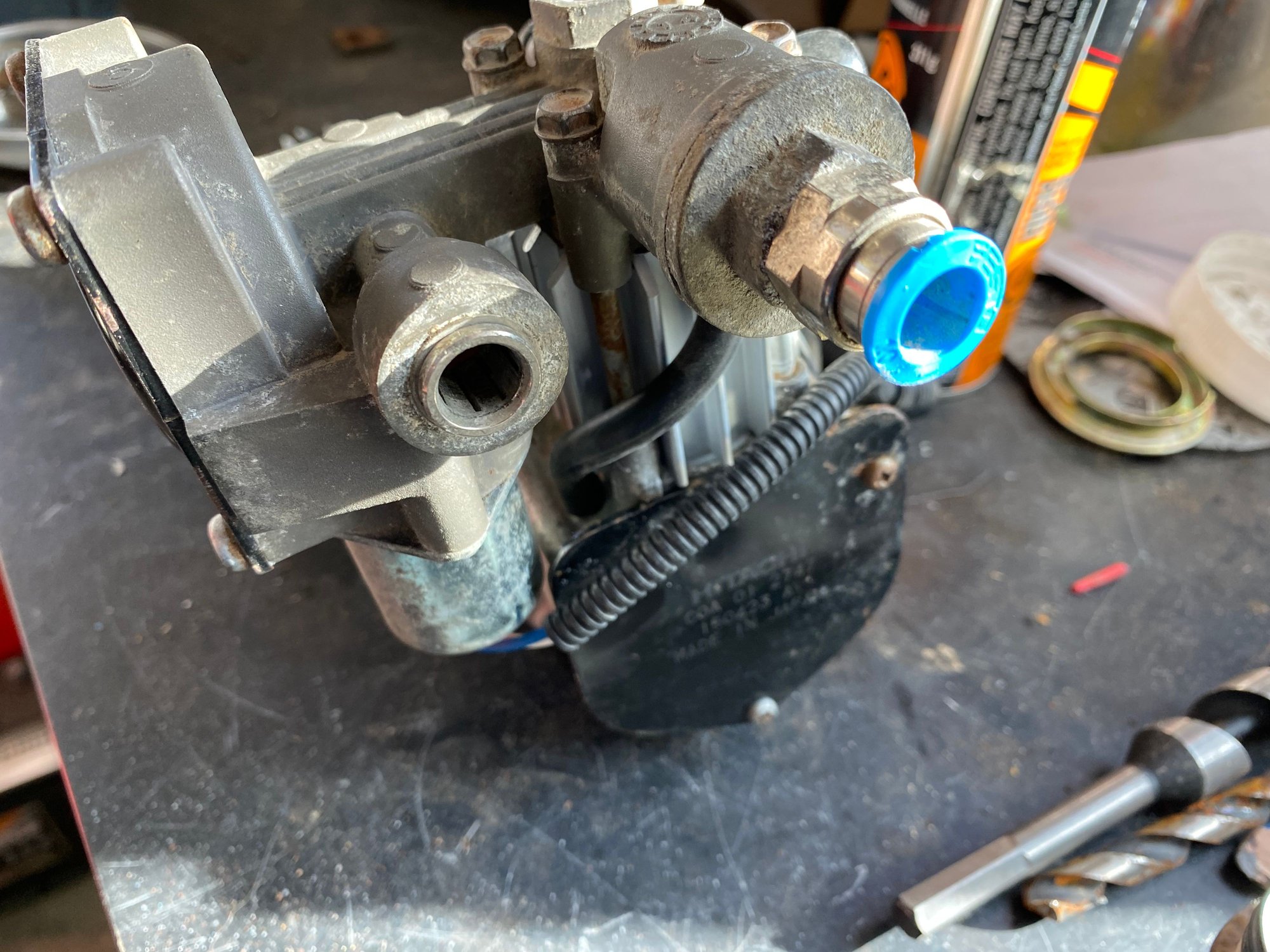

Decided to take it out this morning just to see what I could do before replacing it.
I seems the Voss connectors were loose and the hose connecting one of the ends was some what crimped and therefore probably didn’t have ideal air flow.
I also emptied the desiccant. Over the floor.
Green and a bit discoloured. This is silica gel in bead form no? Can I just use any bead desiccant?
anyway, one connector had been replaced but the other had not. And this was loose. It’s the one on the left in the picture.
It doesn’t appear this threads in rather it sits flush and does the job. Can this be replaced easily with a more modern one?

also…is the air hose 10mm OD?
Old Feb 13, 2022 | 09:14 PM
loanrangie's Avatar
Posts: 1,621
Likes: 266
From: Melbourne, Australia.
10 or 8mm i cant remember, desiccant beads are fine as that's what they use. Get it on Amazon for cheap.
