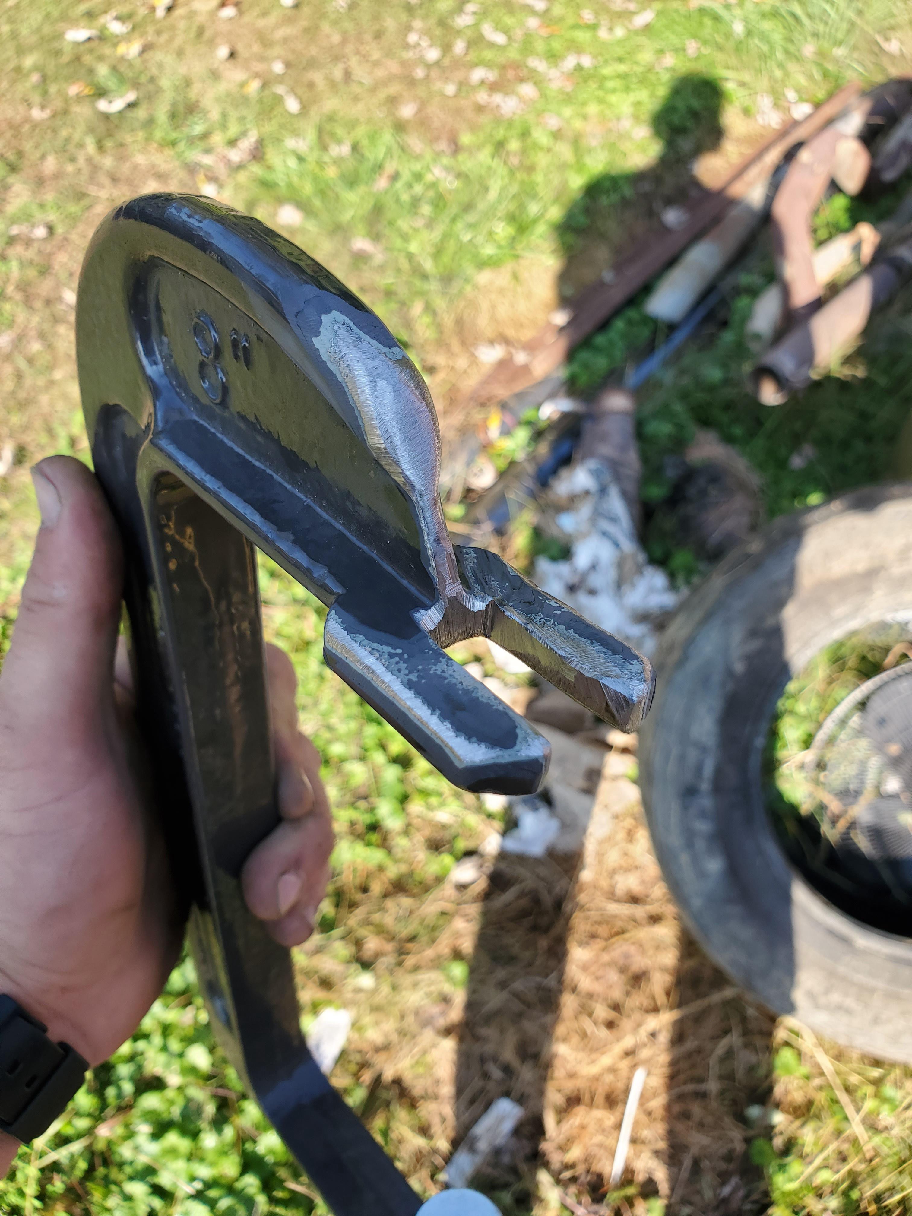

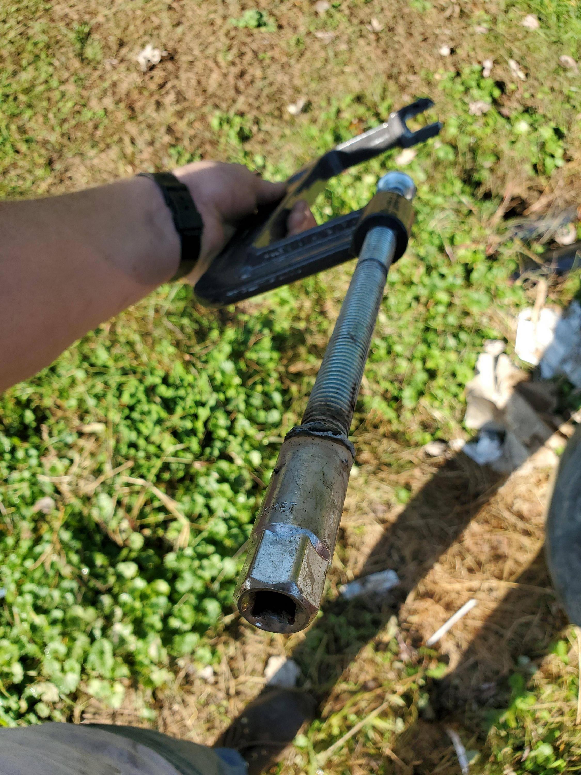

Originally Posted by Red5
I borrowed one like this from O'reilly, worked fine.
F*** these things. They do work, but they're a pain in the butt and they're sketchy as heck.
The best thing I've used is an 8" C clamp from harbor freight with the foot ground out to go around the retainer locks.
I also like to take a cheap 5/8 socket and weld to the end of the screw so I can just run it down with a drill or am impact instead of cranking it by hand. Here's some pictures of mine.
Thanks for the pics, if the one I ordered doesn’t quite work up I’m totally going to fab up one of those, great idea.
