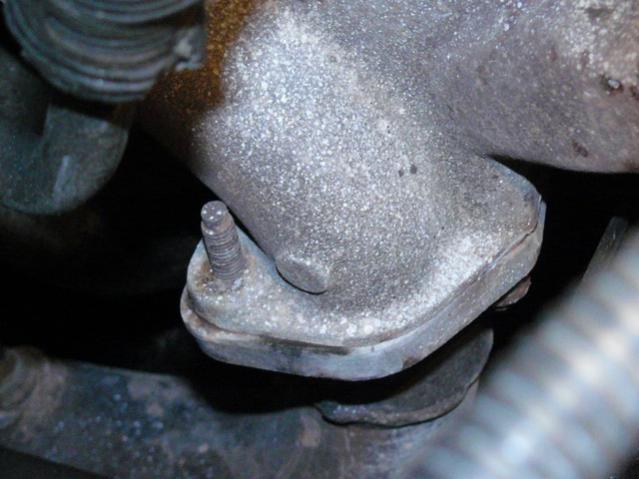

Flange gasket can see if you do Sea foam treatment, will show smoke

Old May 5, 2012 | 09:45 PM
Posts: 16,322
From: Savannah Georgia
See pix.
See black smudge where hot exhaust leaks out. Gasket inside is gone. Can feel when engine cold and started up. Induction cleaning made smoke pour from it.
See bolt that is now one with the rest of the surrounding metal.
See me wait on this little project....
