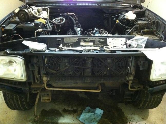

I thought they all have trans oil coolers in front.
Attachment 6067
There are 2 trans coolers, the one in your pic as well as one in the radiator.
