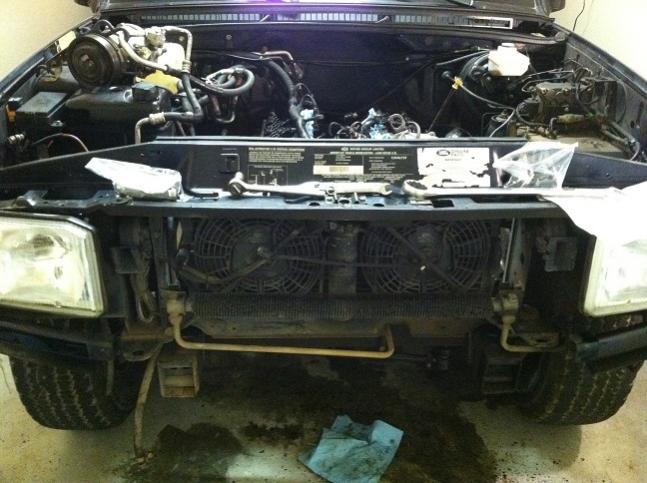

WHEW!!!
No leaking tranny lines, just a power steering hose.
Once the resevoiur is low again I am going to remove the leaky end, cut it off and reattach it.
If it still leaks then I will replace it.
This is the leaking line.
