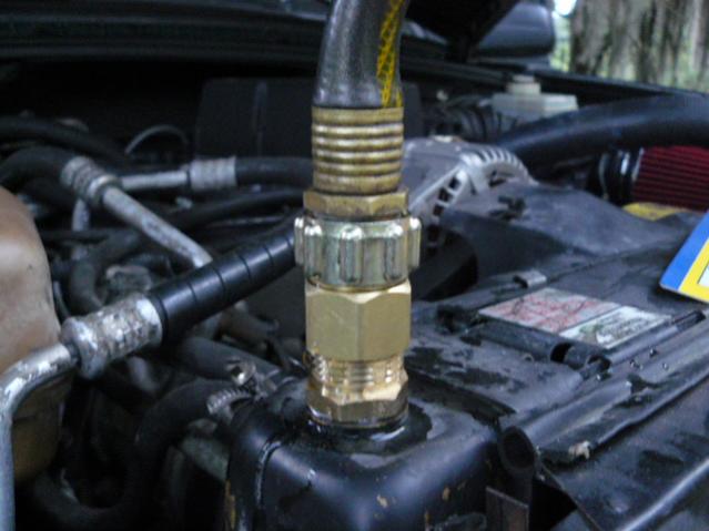

Wen you measure rad with IR I would do it when just turned off. Letting it sit allows convection to change heat readings somewhat. You can also reverse flush it, or flush both ways.
