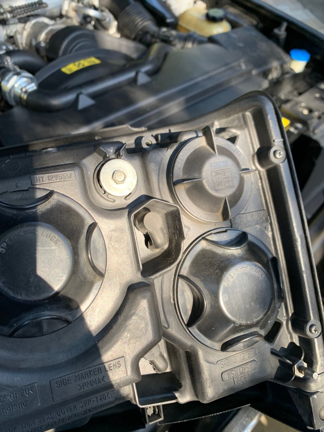

Kept getting a foggy driver side headlight after rain or wash. Pulled the 3 plugs from the back- no more fog.
Looked at the passenger side. It has 3 vents - not plugs. See pic.
Started looking on line for vents - discontinued.
I’ve seen a few pics of used headlights on-line. Looks the same - driver side has plugs / passenger side has vents. What gives???

Very weird. My spare driver's side has plugs too.

Found the vent tubes on eBay and ordered - https://www.ebay.com/itm/1-GENUINE-L...-/265041879907

Great find! My driver side is foggy as well, but the passenger side is all clear.

Waterspots all over the inside of the lense.
More noticeable after a sand / polish / clear coat of the headlights.
Think I’m going to try taking the lense off.

You could rinse with something that dries clear. Just pour a little in and swish it around the lens. Maybe some kind of light solvent? Not sure, just an idea.

Tried that w alcohol and I think it made it worse.
