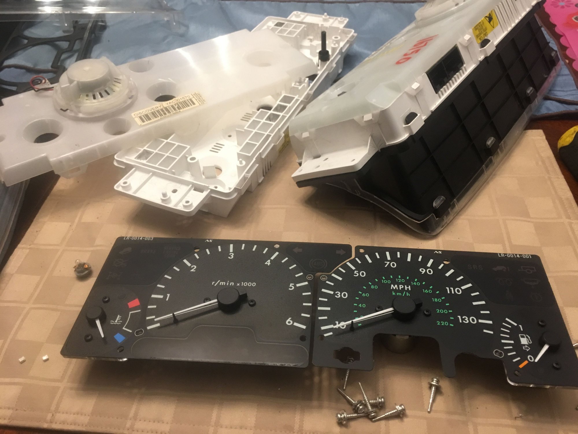

3 options here, #1 LED burned out = very very rare, but not impossible. #2 someone just used some black electrical tape on the inside of the gauge cluster film. Or #3 which I just came across on my 02 Westminster with the 3 Amigo’s not illuminating which is some careless cheap idiot just ripped the LED’s from the gauge cluster which is very $$$ to repair without the proper scantool or spare parts. I had to rebuild the cluster with a replacement PCB with lower miles on it, then SYNC it to the BCU using my NANOCOM LR Specific scan tool.
You can carefully take out the cluster, and then break it down into sections. Then you can inspect the SES LED to see if it’s just covered up or the LED is missing.
***In the pic above you can see the torn off LED’s on the bottom left***
