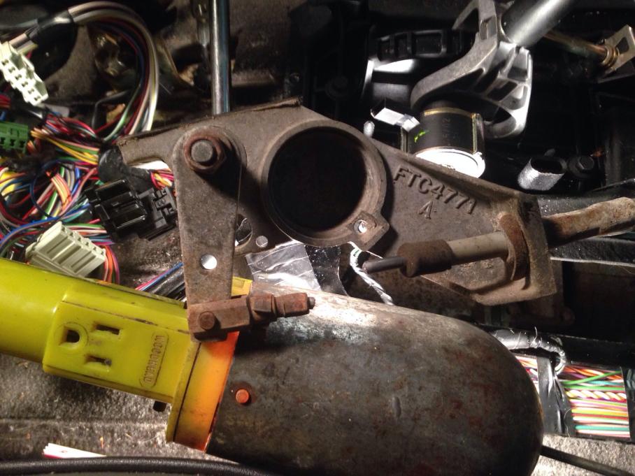

I have a 02 discovery with no CDL. I had problems with my transfer case shifter going from neutral back into high and heard a snap and It appears I snapped the linkage just below the shifter. See the photo. I have taken apart the center console and exposed the linkages. Does anyone know of any sources for the new linkage? I have only found it at rover land parts. http://www.roverlandparts.com/1999-2002discoveryiitransfercaseshifter.aspx

Which piece snapped? I have the part shown in the attached photo. Most anyone would that has done the cdl conversion if they removed it.

Are you sure you didn't snap the cable? I did. The lever on the xfer case was seized. Apparently it had never been put in low range. Going caveman on the small shifter is never a good idea.

I did try rolling in neutral below 5 mph but it still did not budge. Yes it was the cable that snapped and not the bracket. See attached photo.
