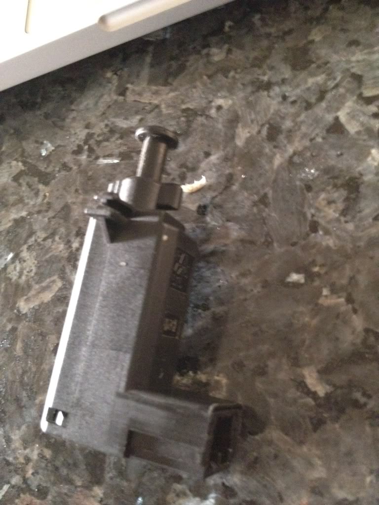

ok, so i reached up behind that black plastic cover under the dash, up by the pedal, and the brake switch popped out in my hand... I unplugged it from the wires and here it is.
so, i didn't see the orientation of the switch, but how do I pop that plastic cover off to see where the switch goes? it has 2 round discs where it attaches. I tried to get a flat screwdriver behind it but didn't do much. or do most pop it back in blindly without removing the plastic cover

Directly behind the brake pedal there is a plate that has an oblong hole in it that will fit the side of the switch with the plunger on it through it. Push it through so it goes through the hole and then turn it and it will lock in place. If you lay on the floorboard it is easier to see the hole. You might have to take the plastic cover off that covers some of the wires and such under the access cover beneath stealing wheel to see it better. This should fix both the brake light problem and the shifting problem. Good luck!

thanks... totally fixed! i was able to get up there without removing the plastic shield. i got a mirror and could see the shape of the slot, inserted new switch and rotated 90 degrees, and got it working. shifting and brake lights work
