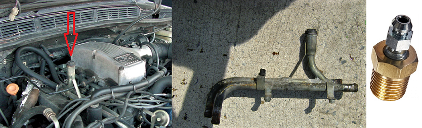

I'm surprised no one has modified a bleeder for the heater pipes.
Like the raised coolant fill on the pre '95 RRC
That thing was great for getting air out fast of the early rigs.
Originally that part was made out of steel, but it would be simple to make for a DII with about $5.00 in copper pipe/Tee fitting.
I would probably replace the solid plug with a bleeder screw.

Me likey this idea
