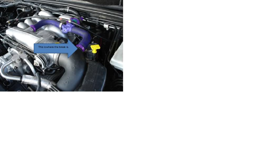

here is a pic of the broken part

That is the line to the idle solenoid. If you have an air leak there then definitely you are going to have issues with your idle. What exactly is broken? Can you try to just JB weld it?

A good epoxy may work well on repairing that crack.

i slapped some blue rtv to try and seal the break, but the nipple connection to the rubber line is broken off, so i need to get this thing replaced. any idea of the proper name of the part so if i find it i can get it?
thanks
ryan
