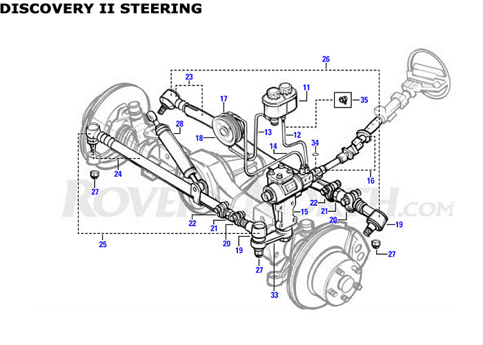

I dont have a pic of mine, but here's a diagram(#28). It is suppose to be mounted at both ends, one to a frame mount, one end to the drag link. As far as replacements, alot use either ome or terrafirma
Attached Thumbnails 03' Steering stabilizer help-404-discovery-ii-steering.jpg

Thanks for the diagram...
What is the bar called (looks like #24 in the diagram)?

see LAND ROVER PARTS - TUBE - DRAG LINK ROD DISCOVERY II LHD
It's called the draglink. You'll find more nice exploded diagrams on the Rovers North web site.
