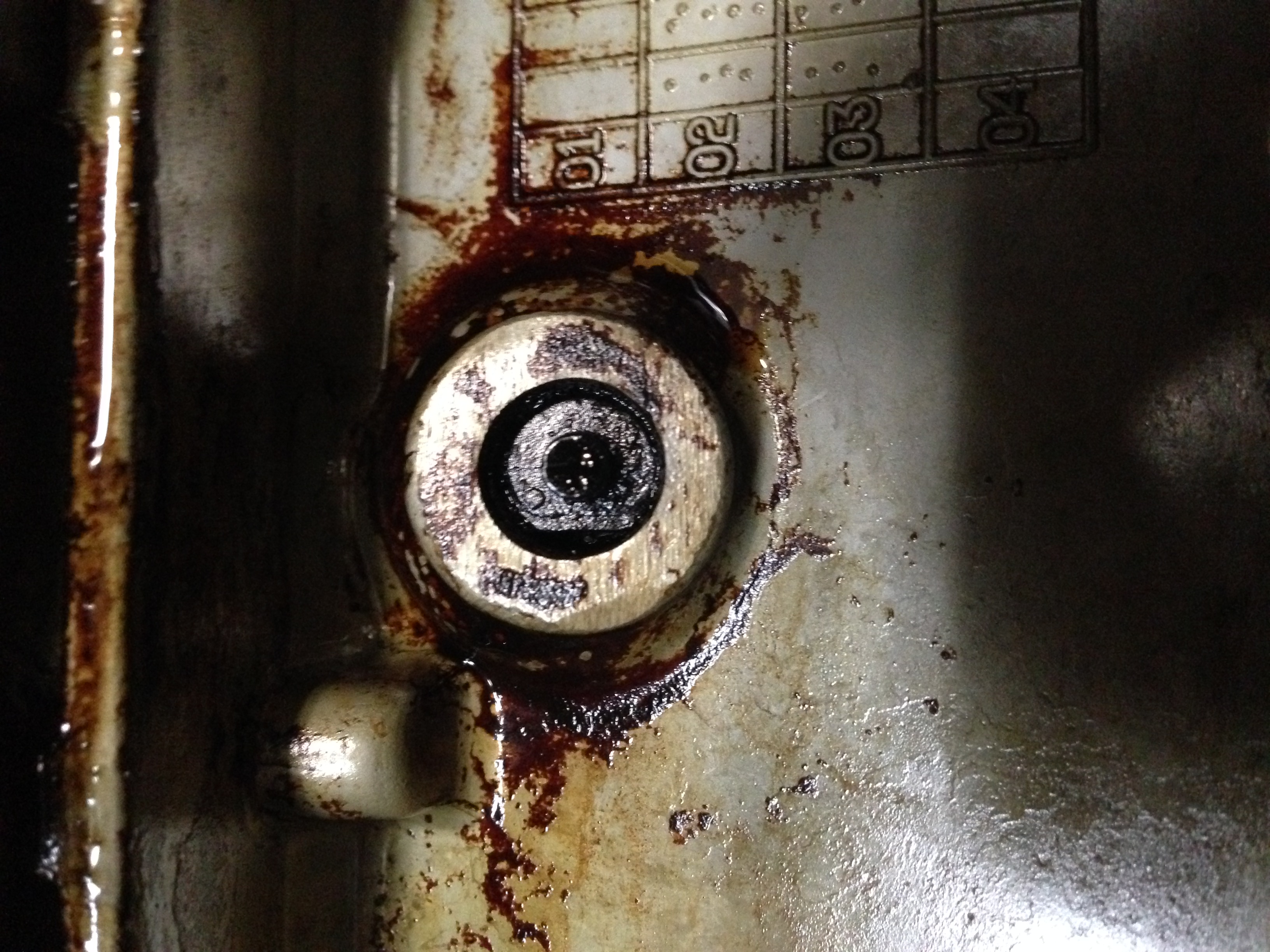

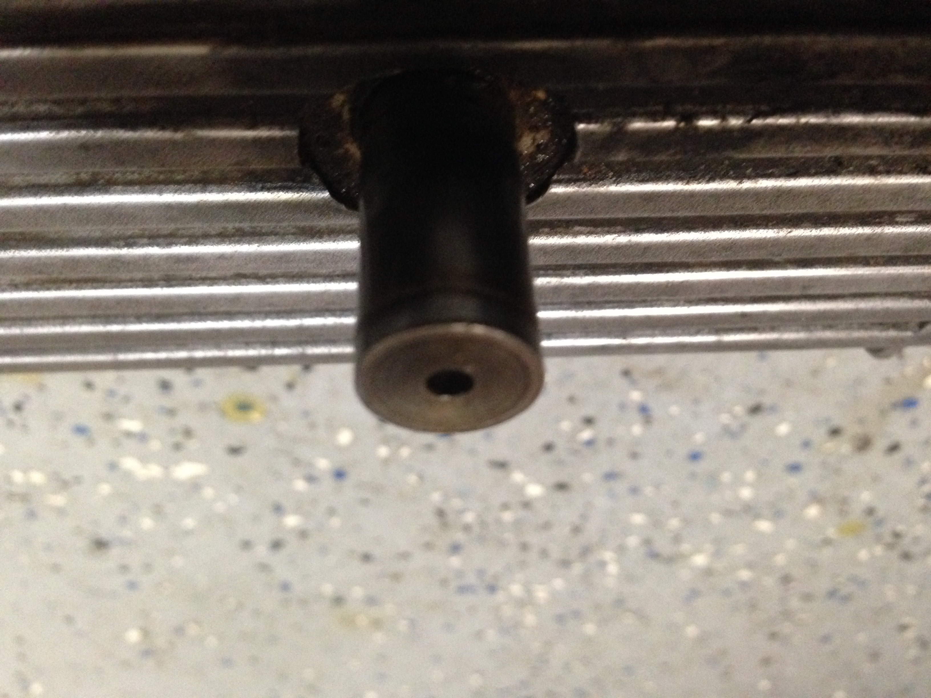

Doing a valley gasket replacement on an engine rebuilt 2 years ago and trying to to the oil separator while I have the rocker covers off.
When we did the rebuild, we just soaked the covers clean in a bath of solvent because I couldn't figure it out then either.
Apparently the later model D2s (03-04?), have a slightly different separator.
As shown in the pictures, the hose side of the oil separator tube has a metal plug on it with a small hole in the middle, while inside the rocker cover the hole in the cover itself is wayyy too small for the oil separator to go thru that way.
Anyone know how you renew the oil separator on one of these?
Seems like 2 options to me:
1. You remove the metal plug from the top of the tube and then press the separator out from the bottom, or press the separator out and push the metal plug out with it (I have access to a press to do this correctly); or
2. You remove the tube from the rocker cover and then press the separator out from the top thru the small hole in the plug.
Has anyone out there done one of these late model oil separator tubes? Advice/guidance would be appreciated.

If you remove the baffe inside the rocker cover, you will have a direct shot at the separator.
pull out with needle nose or tap out from top of tube with needle punch.

Remove the baffle as Abran suggest and punch it out from top or you can break the old seperator up from bottom with flat screwdriver & hammer if it won't push/pull free. That metal tube can also be removed topside with pliers if VC installed, then remove seperator from tube if that's the case. There are also recent threads with pics discussing this if you require more thorough explanation and/or pictures.

The hole between the tube/nipple and the rocker cover is just too small, so I managed to remove the entire tube from the rocker cover.
Soaked it in solvent for a couple of hours, and the old separator pushed right out from the top with no issues.
After surgically cleaning the tube, I broke the new separator while trying to put it in (forgot to lubricate it first), so I reluctantly cleaned up the old separator and put it back.
Though the tube fits snug back into the rocker cover, should I put some RTV sealant or loctite on the tube to assure a good tight fit with the rocker cover?

If I put anything on that separator tube it would be grease or lube, def not sealant or adhesive. It will be fine. If you use copper on the gasket get the spray can, not the brush-on application & use it sparingly.
