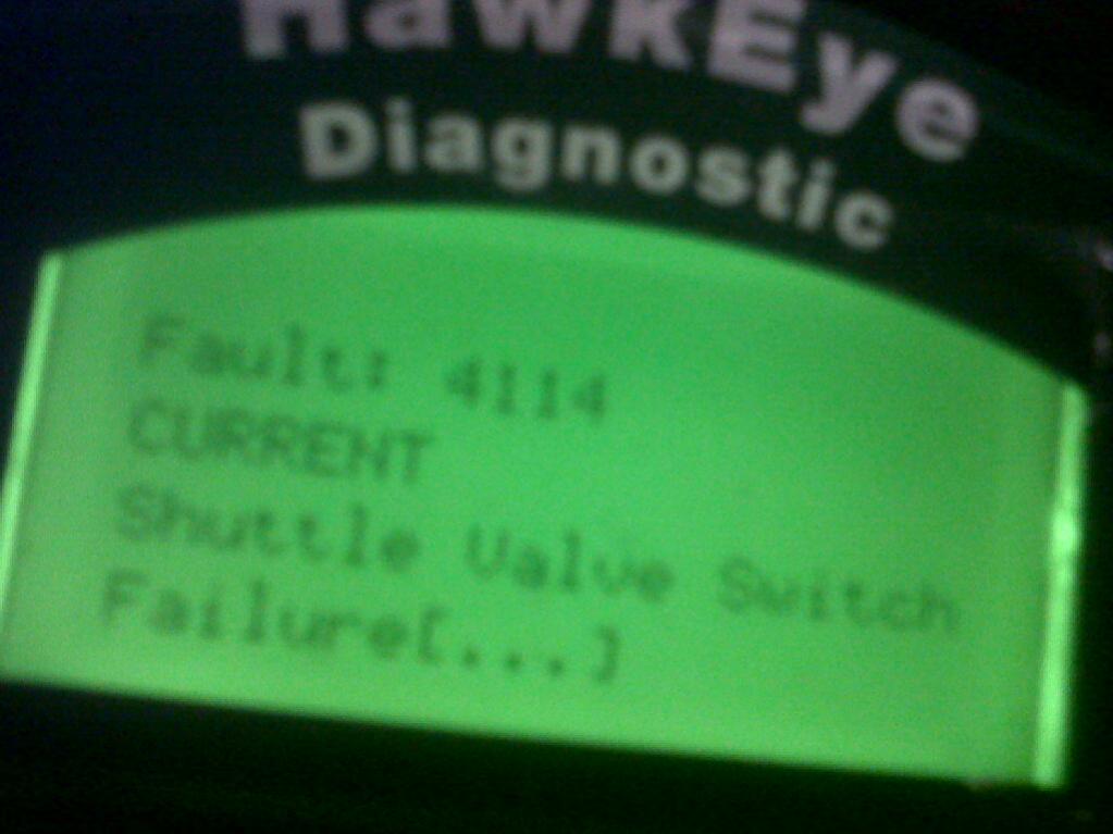

Default P4114 Hawkeye
P4114 Hawkeye
Attached Thumbnails 11 Fault Codes - Discovery II-img01361-20101102-1309.jpg
Old Nov 2, 2010 | 05:42 PM
hilltoppersx's Avatar
Joined: May 2009
Posts: 5,763
Likes: 14
From: Westchester, NY
oh 114 and its not a P code. Thats the ABS shuttle valve fault.
read this. http://www.landroverclubvi.com/abs-mod.html
