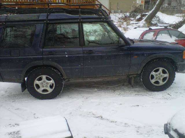

I'm running BFG AT KO 235/85 16's...the picture below is with the stock (11 yr old) suspension...
They've been phenomenal off road and in the snow. I'm installing a 3" lift later this week and don't anticipate needing a bigger tire any time soon...
