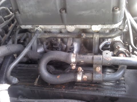

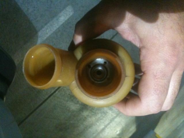

ummm... if the PO bypassed the heater core, did he just plug off each end, or did he install a loop, where water intended to flow thru the core still had an open path? See attached flow chart.
When main stat is closed, no water flows bottom to side arm that runs to water pump. Water from rad comes in small metering holes on the top of the stat. At idle that water warms up the main stat until it opens. Above idle, the water pump makes enough PSI that if the main stat is closed, the bypass disk (with holes in it) is forced down. This relieves some pressure on the heater core.
But if stat is plugged up with gunk, holes don't work. And if heater core plugged off, instead of a small loop of hose used to bridge around it, there would be times when no water is flowing in the stat, and engine will heat rapidly. The system expects to be able to push water thru the heater core all the time, there is not shut off valve in D2s and later D1s.
Bypass plumbing shown on D1, which is "Slang" for "never ending story."

so I rerouted the lines back through the heater core and elevated the coolant bottle. I ran the engine at 1800 rpm for about5-7 minutes then it did start to back up out the coolant bottle. the temp did stay steady at mid level on the gauge on the dash. no overheating. Does pressure build as the engine runs and eventually the bottle overflows or is this a sign of a bad head gasket as jfall said? I ran it for a while before it finally happened I thought I was out of the woods then bam steam!
