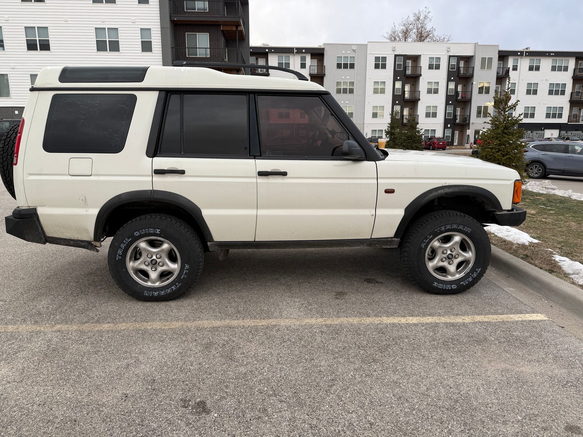

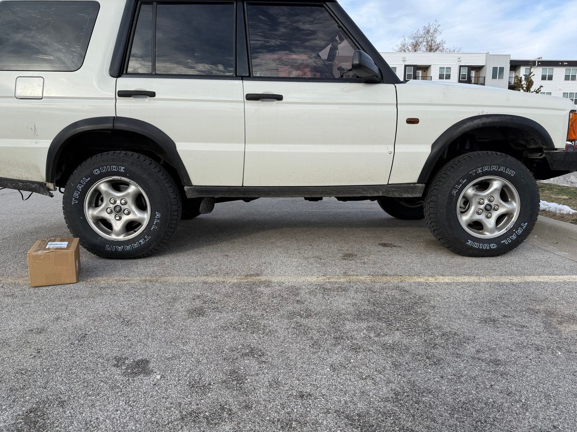

think the problem is I messed up and used spacers in the rear but also used the rear coils that are longer size. I think I need to use the longer size coil rear springs and no spacer. Or, short size front coils on rear with the spacers. But I’m not sure which one?

Take a measurement in the front and rear. Measure each tire from the lower wheel arch to the center hub/emblem. This will tell you how much difference you have in the front and rear. Are you .5", 1" 1.5" sag in the rear? Maybe adding a spring isolator or 2 in the rear can level you out? Are you running steel bumpers front/rear? Throw a picture up showing the sag.

I’ll measure and get some tomorrow. Yes aftermarket steel front and rear bumper. No winch. No tents or anything.
but when using 2 inch rear blocks, are you supposed to use front sized coils then?
or if you use rear large coils, you aren’t supposed to use a the rear 2 inch block ?
lucky 8 is telling me not to use a 2 inch spacer block and rear standard size coil springs at same time? But just to use a rear medium grade coils.
I just don’t know what’s correct?
right now I have again the 2 inch blocks in rear and regular rear size coil spring.
thnx

That's probably your problem. That steel bumper in the back is added weight on those stock springs. Get the measurements and you can see what is needed.

I would fine tune what you have. After you get the measurement of all 4 wheels you have options to bring the rear up. Example: Need to gain .75"...you could add D1 spring perches. This would level you out. Need to gain an 1" in the rear.....Add the D1 perches w/ spring isolators on top of your springs for a little over an 1" gain. As for scrapping your current setup thats up to you and your wallet. That front bumper doesnt "look" like it weighs alot compared to an ARB or TJM front bumper. If you switched to a MD Terrafirma kit you may still have an uneven truck that needs some tweaking. Same with OME MD springs which really only give 1.5". After market bumpers have different weights which will settle differently. Any lift you add may need some tweaking. As Extict said when you add MD or Heavy duty springs your truck is gonna drive more harsh. If you like the way it feels and drives now just tweak the rear to level it out otherwise you may get the look but hate the harshness. If you drive solo and not loaded up on gear you will experience a harsher ride by going to a Medium/Heavy duty spring.
