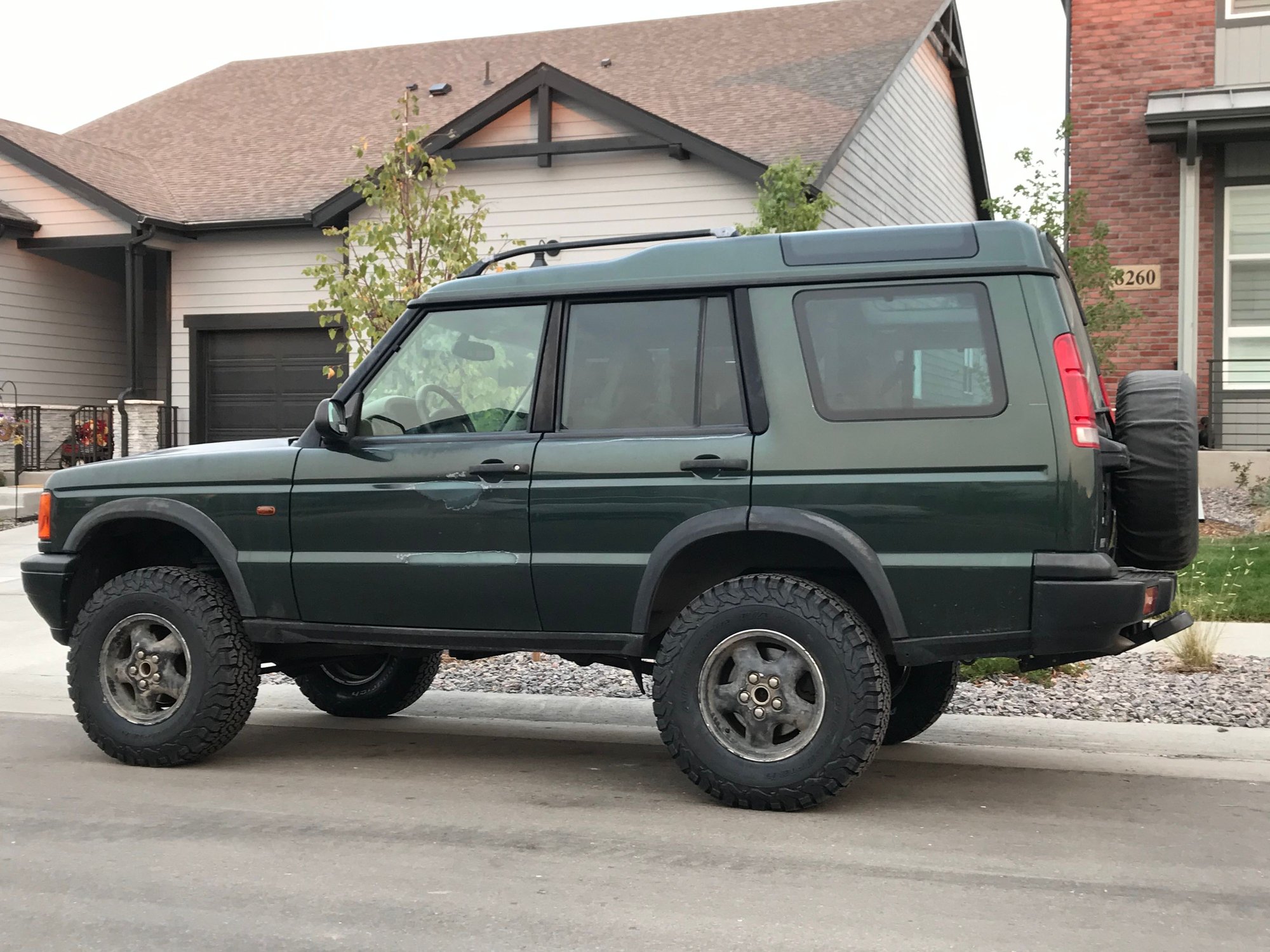

DAP (nvm they were bearmach which is no more . ) big blue springs on this, my text I had written up got deleted...perfect look though for a 265/75.
Gearing helps some but does not solve the lack of power for going up in tire size, especially at elevation. Not a lot of oxygen 5k+ feet.
Do not run load E rated tires in an unloaded truck you will hate it. No suspension set up will make up for that.
A 4.6 might help some more but still going to be not a whole lot of a help (at least where I live).
Manufactures keep the suspension stuff vague as every truck is different. You want to really dial it in then you won't be buying TF or OME shocks. For 2" of lift and a street driven truck you won't really notice the shock lengths, should you upsize? yes, will you destroy stock length shocks? no.
