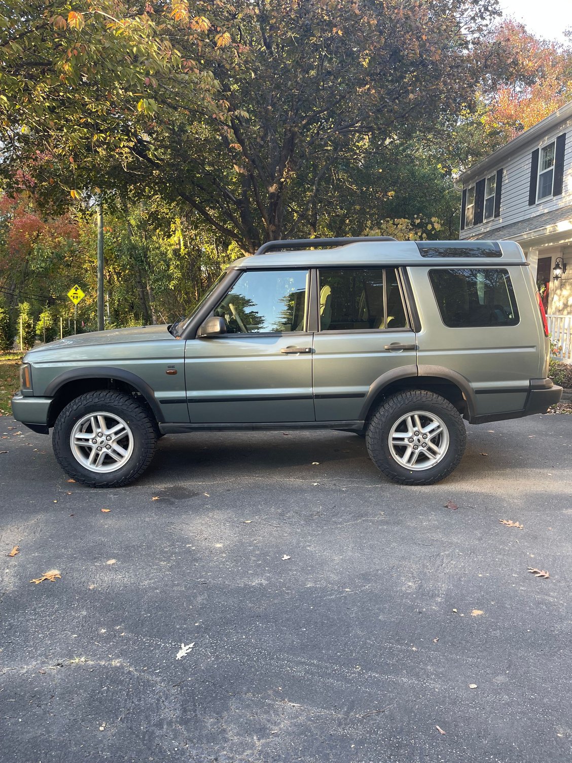

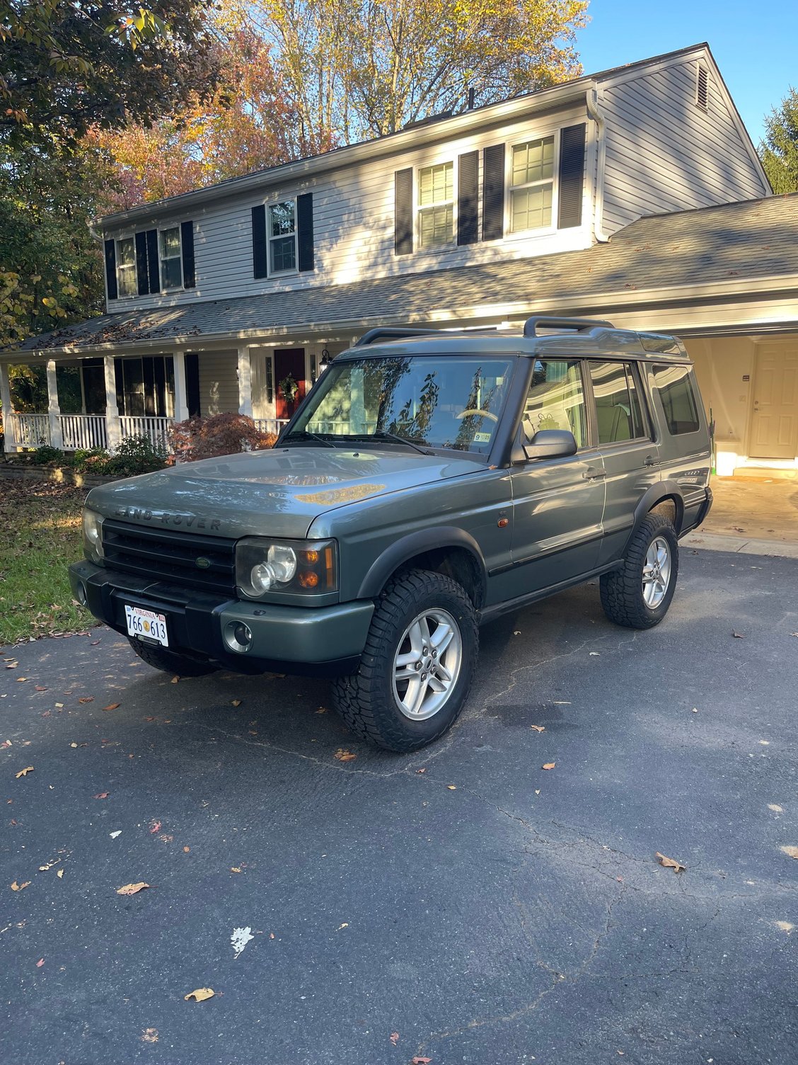

From: Northern Virginia
Lift is on and I’m very happy with it. OME MD springs with the Fox 2.0 shocks. 265/65r18 wild peak at3ws. Doesn’t feel too stiff at all, actually quite cushy. Tires are rubbing a little at full lock. Rear spare was resting a bit much on the bumper so I ordered an extender for BA and have it in the back until that comes in. All in all, I’m thrilled and excited to take this on some trips.
Thanks for all the input everyone, really appreciate it!
