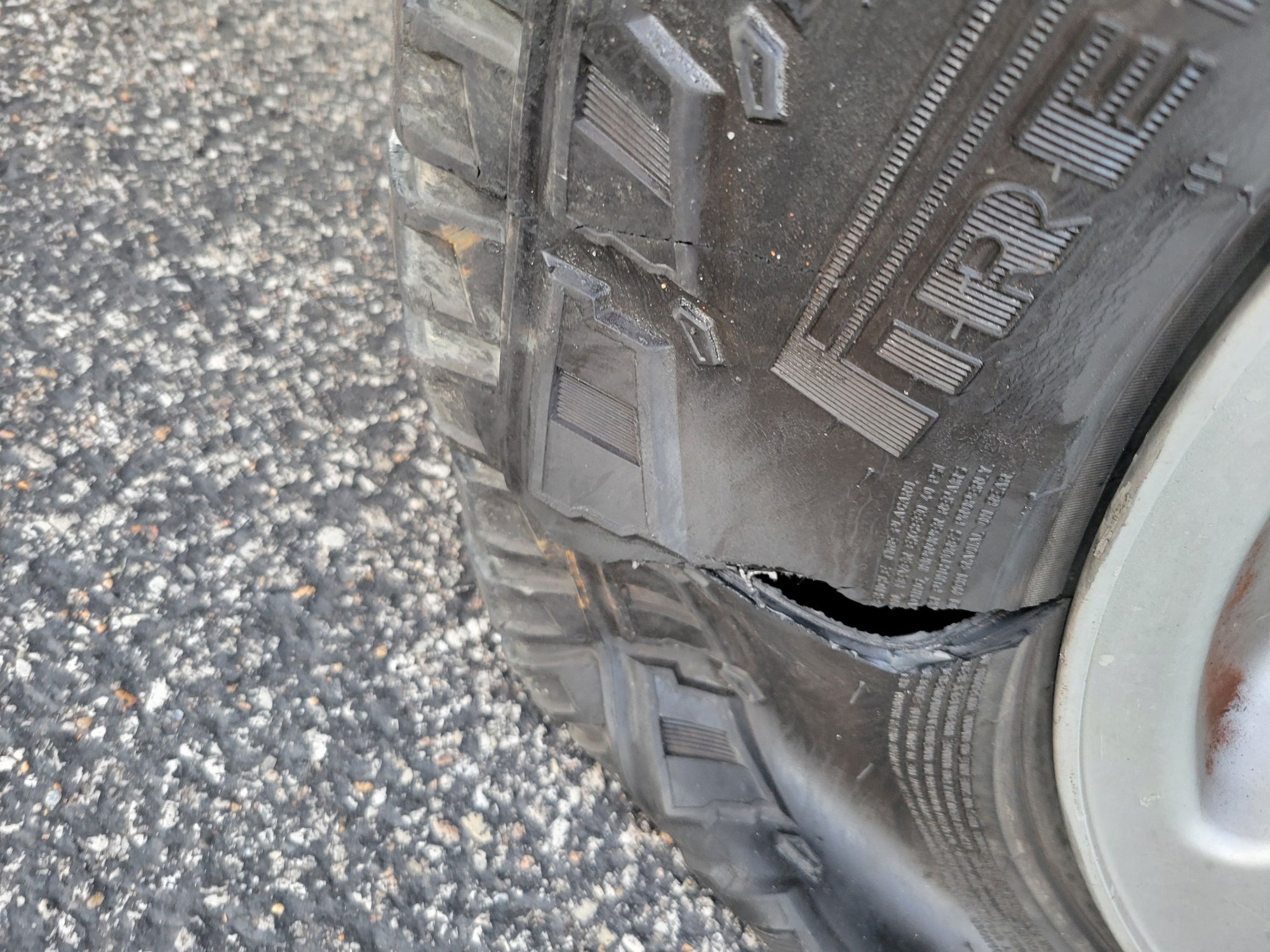

if you are driving the D2 at all, i'd recommend getting the new tires as soon as possible. i just had some 2007 Pirelli Scorpion AT Plus that blew out a side wall at 35 mph on the street. there was no visible prior damage to the side wall when this happened.
i've only had them on my '04 for 3 or 4 years. they must have sat on a warehouse shelf for a long time before they ended up on my Discovery.
put on some 2024 Hankook Dynapro AT Xtremes and the ride is so much softer.

wow that is concerning, glad you were only going 35! Those new hankooks look pretty nice especially for the price.
Yeah the tires are my first priority as their age is really sketching me out. I’ve got a new set of 265/65 wildpeaks at3w which should be delivered today or tomorrow. Was planning on waiting to throw them on with an alignment after I got the lift kit installed next week. However now I’m wondering if I should get them on right after they are delivered just in case. Problem is I don’t think the 265/65 will fit on the stock suspension.
