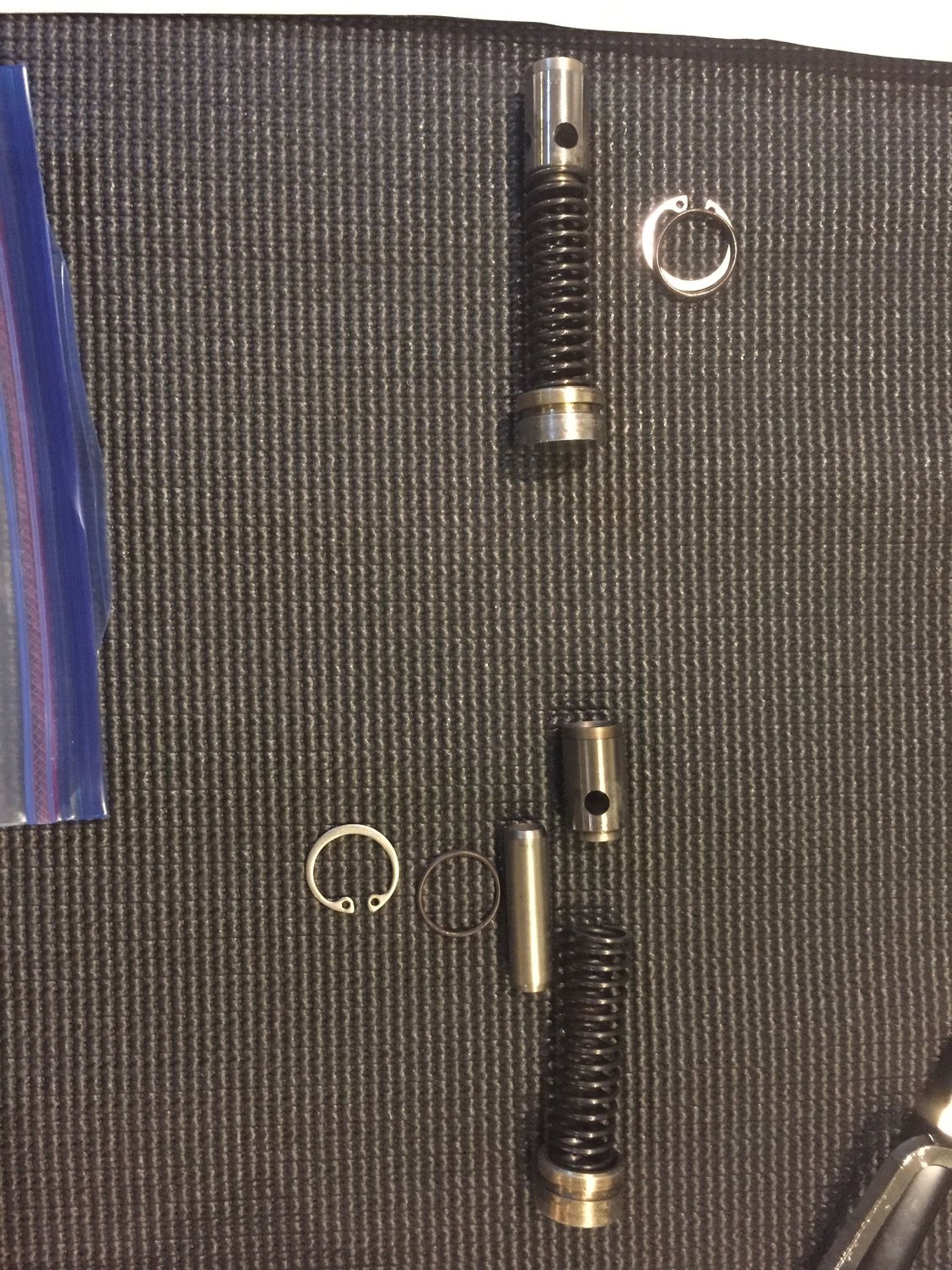

Took apart the relief valves today (didn't know there were two).
They look identical except that 1 has a long barrel inside the spring and the other doesn't. Searched forums, found CharlieV mention identical setups so as usual I'm left with more questions than I started with.
The relief valve as pictured in RAVE (oil filter side) had the extra piston/barrel
Can anyone confirm?

Bump.. does anyone know if my parts are correct or does there need to be a piston for the 2nd relief valve?
Also, RAVE wants me to remove the rotor from the inner gear on the oil pump in order to check tolerances - but they do not appear to be separable.

Never personally pulled either of these so I am no help.
This workshop page suggests they are different but do not show that extra piece that you have.
Land Rover Workshop Manuals > Engine Overhaul Manual v8 4.0 4.6 > OVERHAUL > Oil pressure relief valve - remove

Hey thanks for that link! I don't have that page in my manual, so I checked the editions.. mine is a 3rd edition from land rover service factory manual RAVE download land rover resource, service manual, workshop factory manual, download, rave, vehicles including discovery, series, defender, range rover, freelander, LR3, Handbooks, Catalog, Catalogue, Land Rover Inte
The one there is a 4th edition. Looks like my setups are correct.
Is there a downloadable PDF version of the 4th edition anywhere?
edit: found it here
https://www.sugarsync.com/pf/D870012...tDownload=true
Great save Red5. Thanks.
