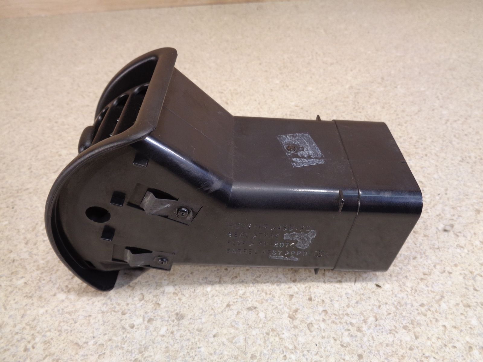

Default Vent
So here is a vent. Does it just slip out or do I have to clear a clip in the top and bottom??
Thank
S
Old Aug 13, 2017 | 01:50 PM
Sean Winter's Avatar
Joined: Jul 2017
Posts: 120
Likes: 13
Looks like the side metal pieces are the problem. Recommend to just pull hard?
Old Aug 13, 2017 | 03:13 PM
Joined: Jul 2017
Posts: 120
Likes: 13
Best way to remove is pop the inner vent out first. Then grab through the top and bottom and pull out. No breaking.

Thanks for the pics. I think most "modern" cars have the press in style vents and nozzles. Its just a matter of finding the tab to push and clear the housing...
