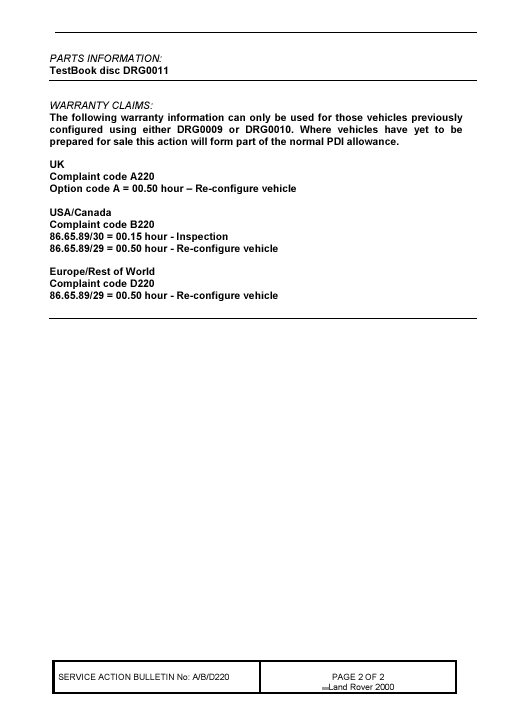

There is a recall action to make sure the vehicle is configured to "Power down" the windows after turning off the ignition. It "may" be this that you have an issue with. If it is, it would be fixed for free at the dealer. Check you VIN number to see if yours is in this range........

Thanks mine is in this VIN range so this is good information.
