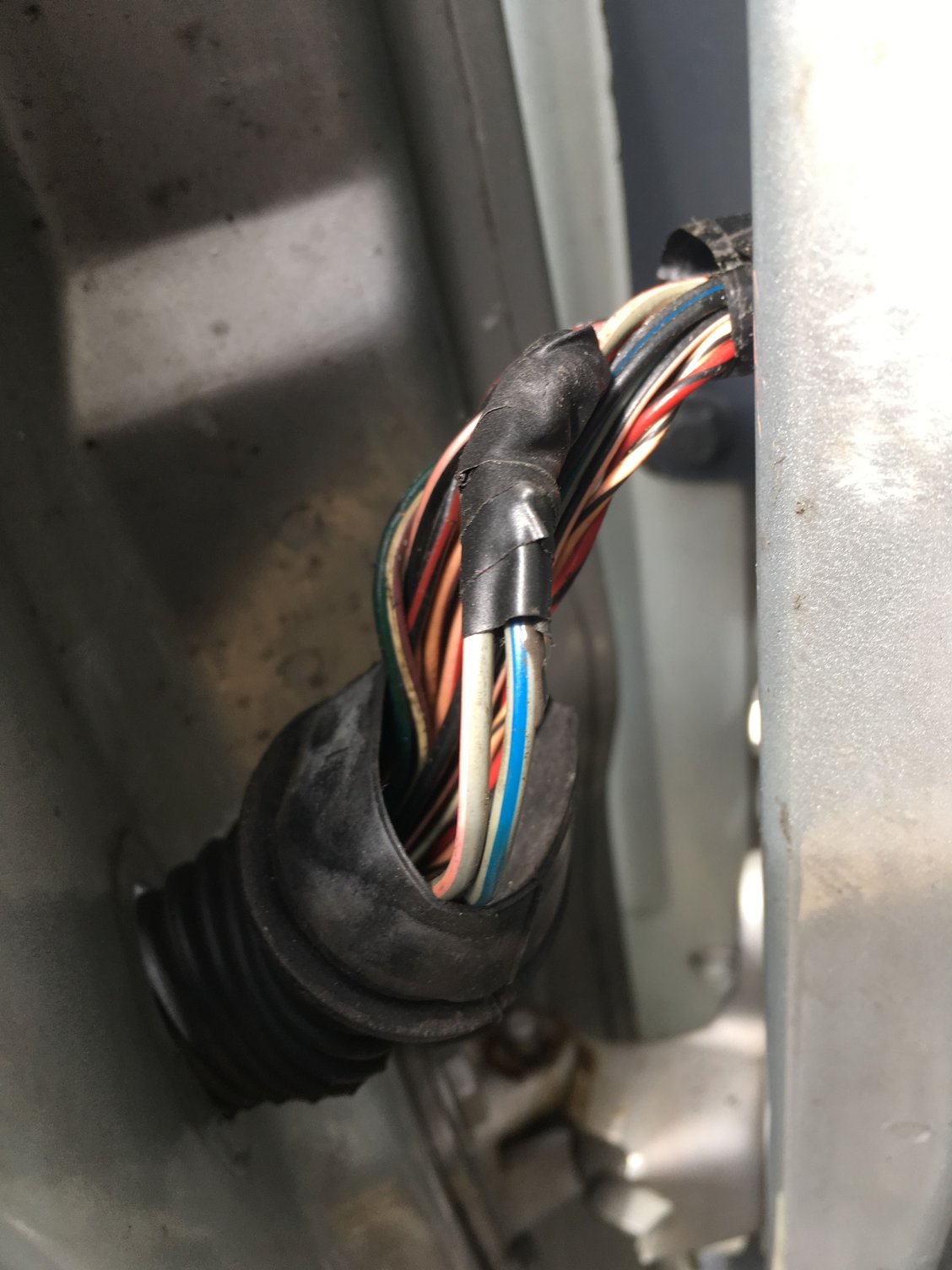

Old Jul 23, 2017 | 12:43 PM
LR03NJ's Avatar
Joined: Feb 2009
Posts: 2,186
Likes: 200
From: Linden, NJ
Default Found problem
Wire between the dioors got cut off
