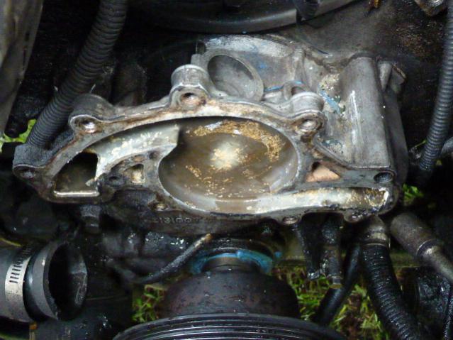

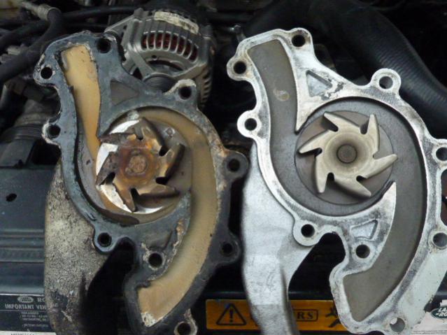

7. Water pump gasket failed allowing cross over, or impeller lose on shaft. Gasket is $3, remove new WP and inspect. Pix shows an old and newer pump, uses a complex gasket, not just around the perimeter. Old WP wobbled and ate up aluminum, if it also did this on the front bulkhead of the engine might have made a penetration, which shop should have caught when replacing WP.
8. Slipped liner does not sound like it since you have a negative combustion gas test. Might want to do a mechanical oil pressure test both cold and hot, at idle and 2000 rpm.
