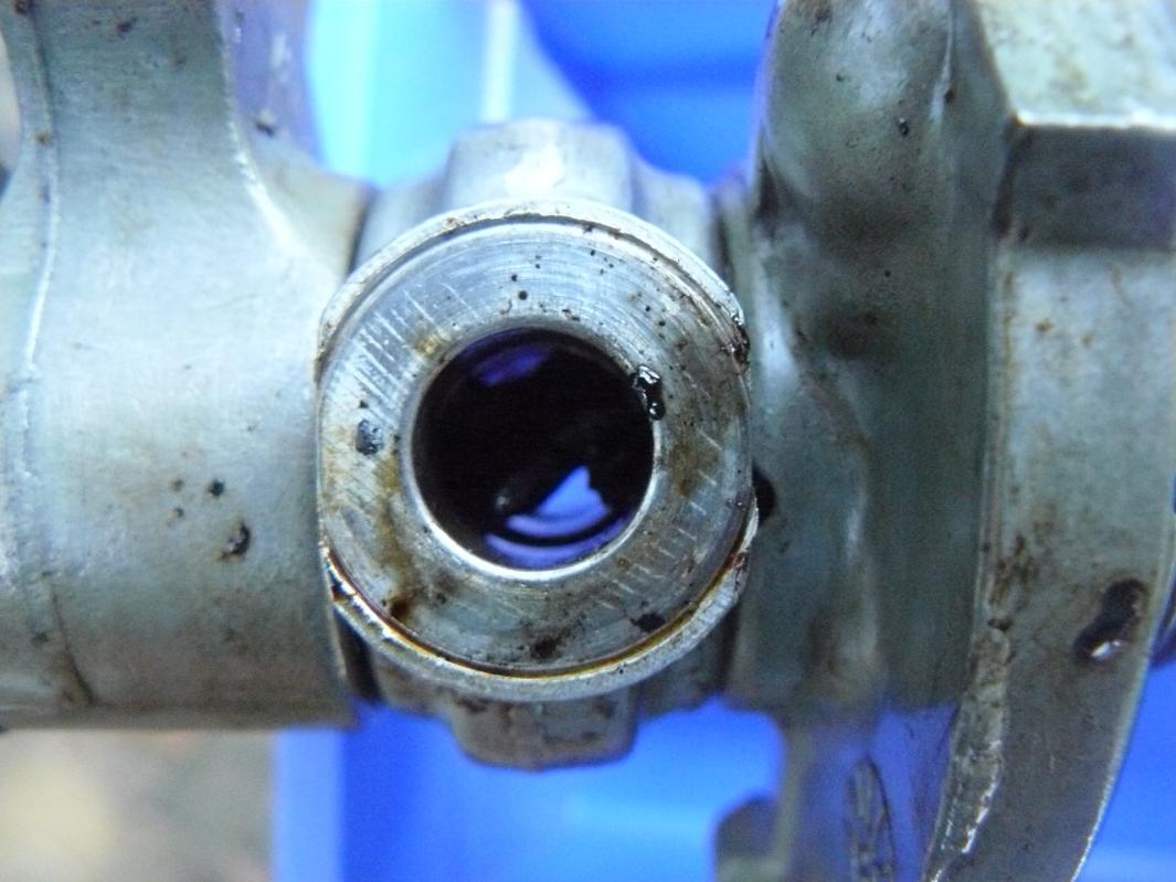

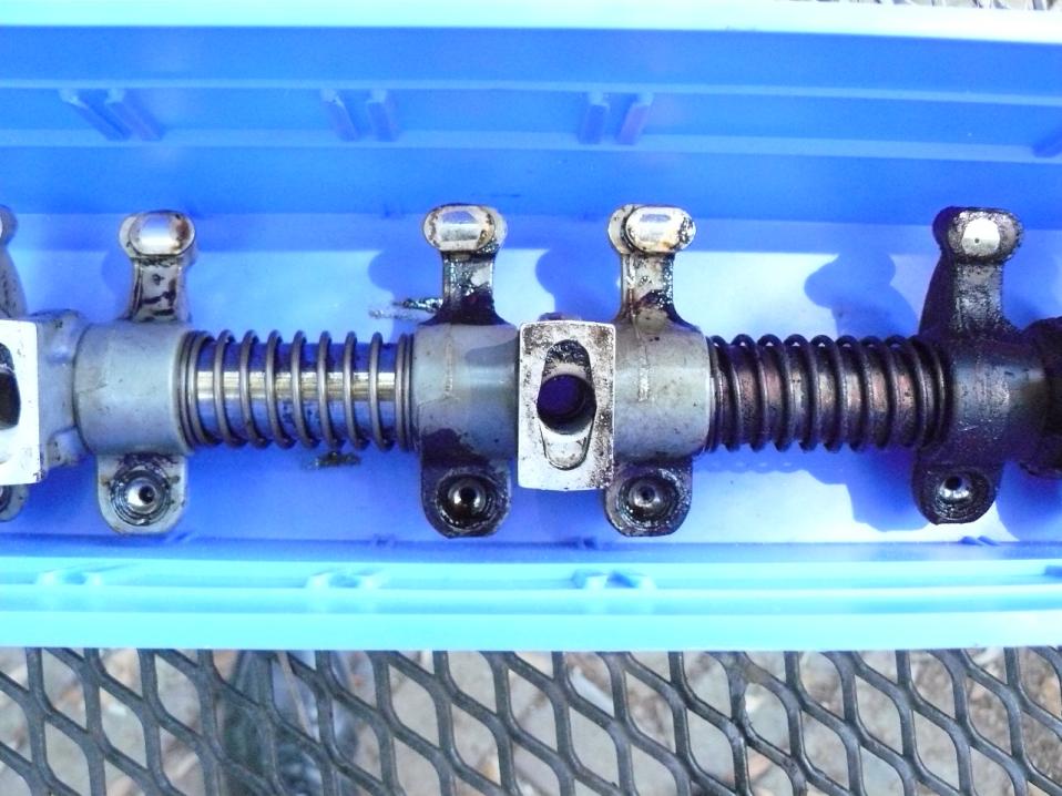

New plug wires, test the fuel pump pressure (test port under top half of intake - won't ever be so easy to get at again). Clean out PCV system which vents the oil fumes from the valve covers.
Be prepared what what you might see once valve covers are off. If rocker arm assembly looks bad, it can be removed with four bolts, and soaked in cleaner (I used Berrymans), The rocker arms slide on the shaft and are held by springs, so you can clean out holes, etc. Even use some 1500 grit sand paper to remove mild wear marks. Of course anything you can feel with a fingernail and you'll want to look at more parts.
If playing around under the valve covers, make sure original parts go back in original places.
Many valve covers leak and need to be snugged up with 8mm 12 point skinny socket. Some put a dab of the weakest locktite on these bolts. That might be worth a try first. When you think about it, they normally would have been done along with the HGs, the whole kit of gaskets is like $90 - $120. If they were not, and only the HG were done without machining, etc., then maybe the HG job was cheap and less than complete. It would be a good sign if heads are mucho cleaner than the block, as they would have been hot tanked by the machine shop. So at least were checked for flatness if not also machined.
You'll want your own copy of the shop manual, called the RAVE, free in links below. Owner manual and electrical plans also there.
Attached Thumbnails 2001 Discovery the good, bad and ugly-p1130070.jpg   2001 Discovery the good, bad and ugly-p1130071.jpg   2001 Discovery the good, bad and ugly-p1050979.jpg   2001 Discovery the good, bad and ugly-p1130074.jpg
