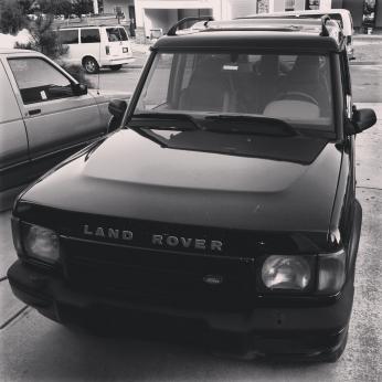

Had 255/70r16 Michelin M/S2 installed today. I know they'll last forever but how do these compare to more aggressive tires from Michelin? 30 days to try em and switch, I'm open to Michelin tire suggestions too.
