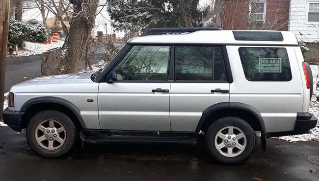

Option 2: 2004 Discovery 2 for $3000 negotiable...
Miles: only 86,000
Excellent condition
Pretty much stock.
Well cared for, used for this private sellers family mostly.
Known issues (or at least disclosed to me):
Just started taking a while to start up in the cold, and he is not sure yet what the issue is, and might even be willing to drop the price more as a result if he doesn't get it fixed himself.
2004 Discovery 2

An 04' Disco with 86k miles for $3,000 negotiable? What am I missing here? Am I reading this correctly or are my contact lenses sticking to my eyeballs again. It looks like an SD. Private party. Stock. Dood, get the 04'. If the price is negotiable offer $2k and go from there. Have you seen undercarriage photos? Any major rust? Service records?

I'd buy the 04 if it is clean and rust free even if the motor was scrap at $2k

Yeah. 2004 has the Center Diff Lock stock. Bonus!
You'll want new offroad tires on it so budget there. Check for no major frame rust underneath and for overheating on your test drive.

The slow starting is probably the starter. My ‘03’s starter wore out last year. Sounded like a sick cow.
