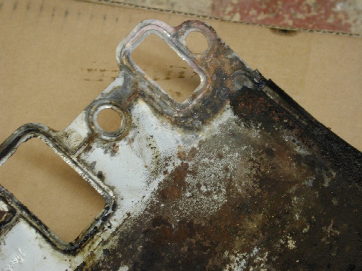

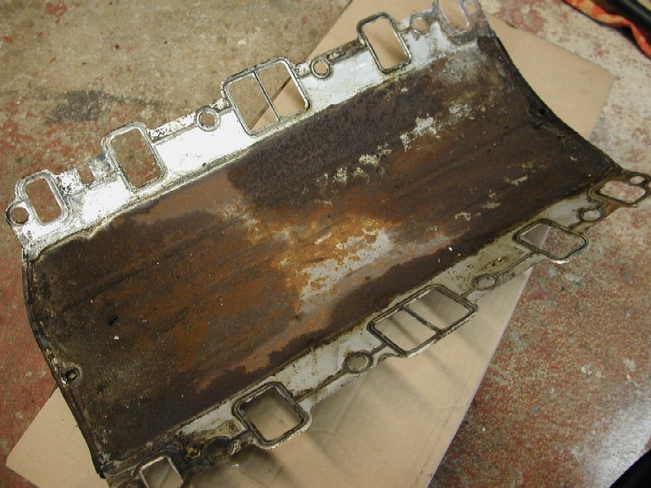

Cleaning out my pc and I found some piccys from when I did My valley pan gasket on my D1.
You can clearly see the top corner (rear left corner when installed) is where it has leaked, then runs down onto the bell housing.
