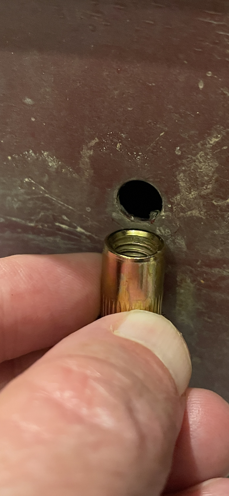

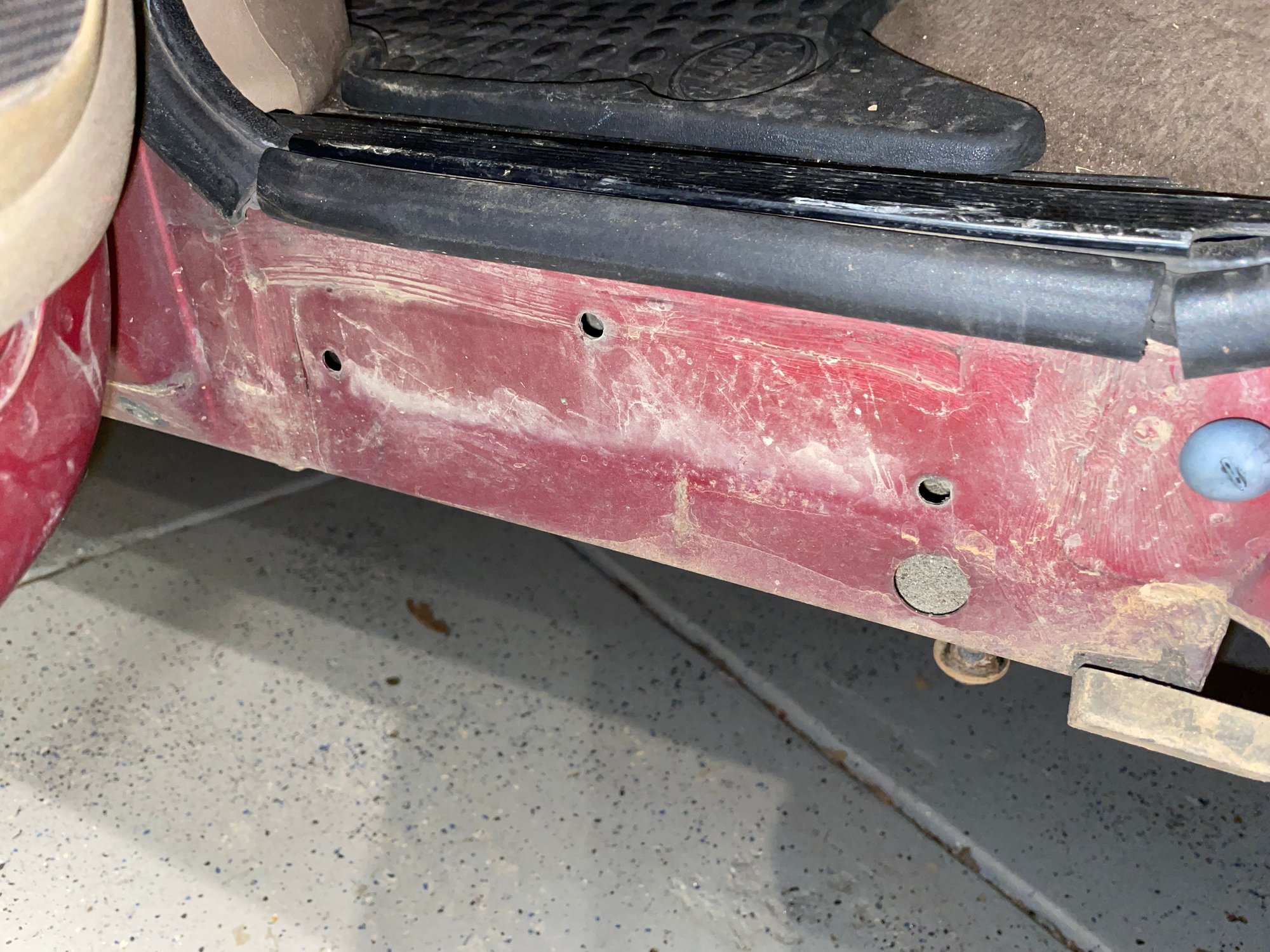

I was happy to see that the SG sliders use the holes already there for the plastic rocker covers, but when I removed the running boards and the plastic rocker covers today I found that the holes are too small for the rivnuts I need to install to mount the SG rocker guards.
The mounting bolts I got with the rocker guards are 5/16-18 (Grade 8). They are very clean and I see no reason to not reuse them. But, I will have to enlarge the holes in the sill to 7/16". No biggie for most of the holes, but the one most forward behind the rear doors (furthest to the left in the pic) is not accessible with my drill without taking off the door, which I am understandably not keen to to do.
I suppose I could use a smaller rivnut for that location, or buy a right-angle drill from HF, or even skip it altogether and rely on the other fourteen bolts per side.
What do you guys think?

It turns out Lowe's has a right angle drill adapter for $20 so I plan to try that. Stay tuned!
