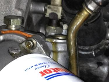

ok here is an update, the 2 bolts seem to stop after tightening some more like hhalimi said. but the one that i thought was the oil filter housing with the o ring is not. it looks like its coming from the oil pump pressure relief hole on the bottom. what would cause this and how do i fix it? do i take it back to my machinist? or can i fix it myself. its a steady run of oil pretty much. i took a picture of it.

I got a blow up diagram from another post for the timing cover leak. But in the blow up it shows a snap ring not a freeze plug. Now i just realized i got a snap ring on top hole and a freeze plug on bottom hole? Can anyone check to see if this is correct please. I cant tell looking at diagram. My leak is from bottom hole.

See this extra page from the overhaul manual section on 4.0 and 4.6 liter engines. It seems to indicate that not all engines would be fitted with the oil pressure relief valve, which would explain the plug.

So how do i fix this thing? My machinest said he can make me a plug, as far as new front cover is not in my budget right now. Used one on ebay is listed at $650.
What would you guys do to seal this thing?

Look like this, only cleaner? Seems like lower one is like a freeze plug, and upper has that snap ring. After getting old plug out - be sure they wipe a magnet around inside. The cold oil will hold any metal shavings close by. Front cover is aluminum but plug won't be.
Sure it is not coming from oil pressure switch just up the road? If the plug is leaking, can it be knocked in a little further (use correct size socket to fit, not a screw driver)?
