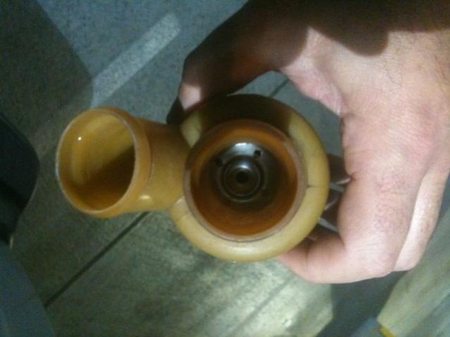

1. Check fan clutch - fan when cold should spin a partial turn when released, feel like peanut butter inside it. When engine warmed up, should still spin, just a partial revolution, not freewheel. If it spins freely, oil inside it is lost and it won't cool truck below freeway speed.
2. Check electric fan - does it run when AC is on ever? Blades should spin freely, and fuse in underhood box should be good. A fuse that blows and/or blades that don't spin indicate a fan motor siezing up, and not enough cooling below freeway speed with AC on.
3. You have a bypass style thermostat, and if you have air in the coolant system (from a leak or worse - exhaust gas from head gasket), heat inside truck wil be on/off as bubbles move around. Coolant is always flowing thru heater core, even with AC on. If you hear gurgles or water rushing, that's a problem. Purge air, top off coolant and bubbles should not keep coming back. Thermostat hoes can get clogged up with coolant system work, and make the stat not work at correct temp.
4. Temp gauge is most inaccurate, if you can get your hands on a scanner or ultra gauge and read temps from OBDII diagnostic port you'll have a better idea of what is going on before temps get out of hand. You may be at 240F or higher. Good idea to change thermostat. There is an 82 C soft spring one that makes truck run about 10F cooler. If you see truck is rising above 220, what is the point letting it go to 240 - 270?
5. If unable to keep cool in center of gauge at freeway speed, in addition to head gaskets, can be low coolant (leaks), bad coolant cap (maintains PSI up to 18 before venting), partial blocked radiator (will show up as cooler on bottom area than top, usually by a lot for than 10F). The rad can be flushed, but usually not effectively, the passages are very small. It is fed horizontally, so should be same temp top to bottom (within 10F on a new one). Sludged up and you don't have enough flow. Rads $150 - $230. $50 at junkyard, but could easily have same sludge, just dried out to a brick.
6. Can be water pump, like impeller blades missing. $3 gasket and a lot of elbow grease to inspect. There are after market pumps with larger bronze impellers.
7. Head gasket will usually put exhaust gas into coolant (bubbles), coolant into cylinder (white smoke), coolant into oil (milkshake), coolant leak external. Before going down that money pit, a $50 exhaust gas in coolant test from parts store might be a good idea.
Murphy's Law comes in a multi-volume set, and you could have more than one problem. In addition to warping heads, killing head gasket, you can also cause a cylinder liner to come loose, and begin tapping when warmed up (no, it did not magically convert to a diesel). Operating at high temps is reserved for life threatening emergency, or guys with heavy checkbooks. To be fair, understand that the gauge is designed to point at the 50% mark until overheating begins. Anything above 50% deserves immediate attention.
And the coolant is a closed system, it had to go somewhere if it is low. Sometimes that is a sneaky leak around a hose connector, of which there are many.
Attached Thumbnails 2003 Disco 2 Seriousely Overheating!!-thermo%2520inside%2520top.jpg   2003 Disco 2 Seriousely Overheating!!-pittsburgh-20120905-00034.jpg   2003 Disco 2 Seriousely Overheating!!-dex-cool-2.jpg
