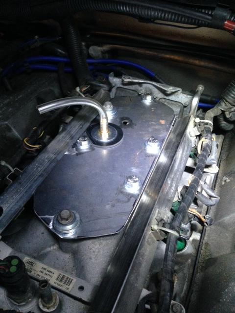

OK, here it the update on the finds of the P0171 code cure.
I performed a smoke test and found a bunch of smoke pouring out from what appeared to be my intake valley pan gasket. So before I pulled the lower portion of my intake I decided to check the lower half of the intke with the smoker by making a special adaptor plate by using the upper intake gasket as a template. (see photo)
This revealed that I had multiple o-ring leaks at my fuel injectors. The cure was a rebuild kit I found on e-bay (Mr. Injector).
So I put it all back together and whoola, no more codes and it runs like a champ!
