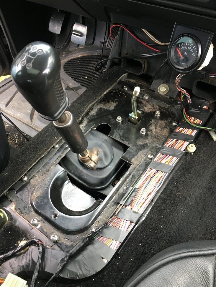

Nice build...shows all the detail...but he did not install a locking t-case?

@XRAD he had an 04 so it should have already had the locking T-case
He also references the shift lock ability in some of the later posts, and you can see that the t-case lever has the lock symbols on top of it.
Old Jun 8, 2020 | 07:55 PM
XRAD's Avatar
Joined: Feb 2019
Posts: 1,288
Likes: 445
You know what , I missed that. I just saw the pic of his tunnel cover and it was not slotted for locking shifter... guess he opened it up later
