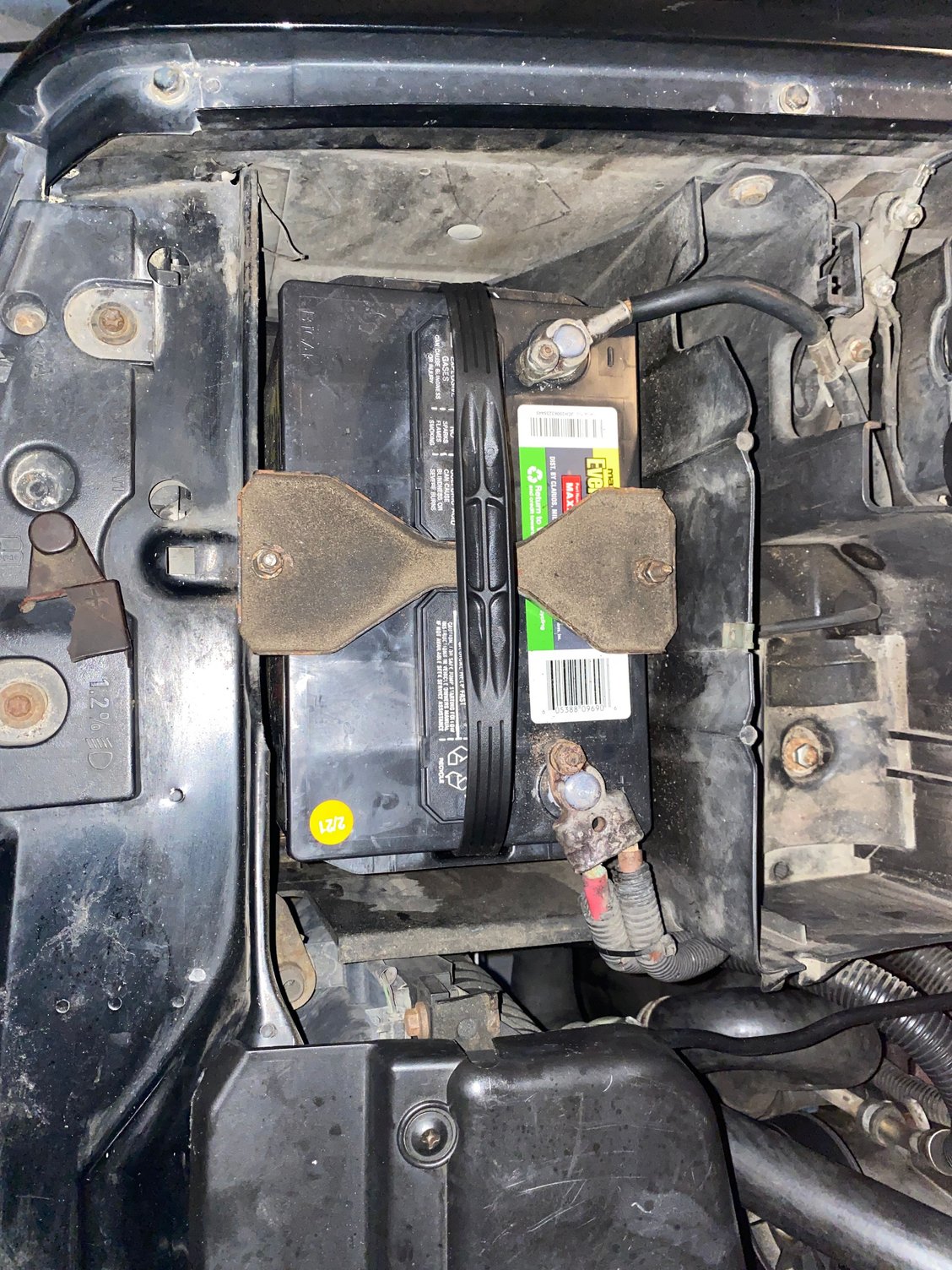

Thanks so much for the reply’s. The foxwell N510 was the scanner I found that does the Land Rover “apparently it also does Jag”. I have cleared the codes, when I clear them using the scanner as a obd2 reader the service engine light turns off until the vehicle is started and the codes return. Always the same codes. When I bought the vehicle it had a dead battery so it now has a brand new battery and the terminals are clean. Although I will take a wire brush and make sure the connection is perfect.

Now that I look at the picture I posted the positive terminal looks like a disaster. I’m pulling it off now and will inspect and clean. I’ll post pictures and results once that’s done

Yeah I see it too. It also looks like the positive cables aren’t seated well in the battery clamp.
you can ‘forcefully’ wiggle both positive cables to make sure they are secured in the clamp.
