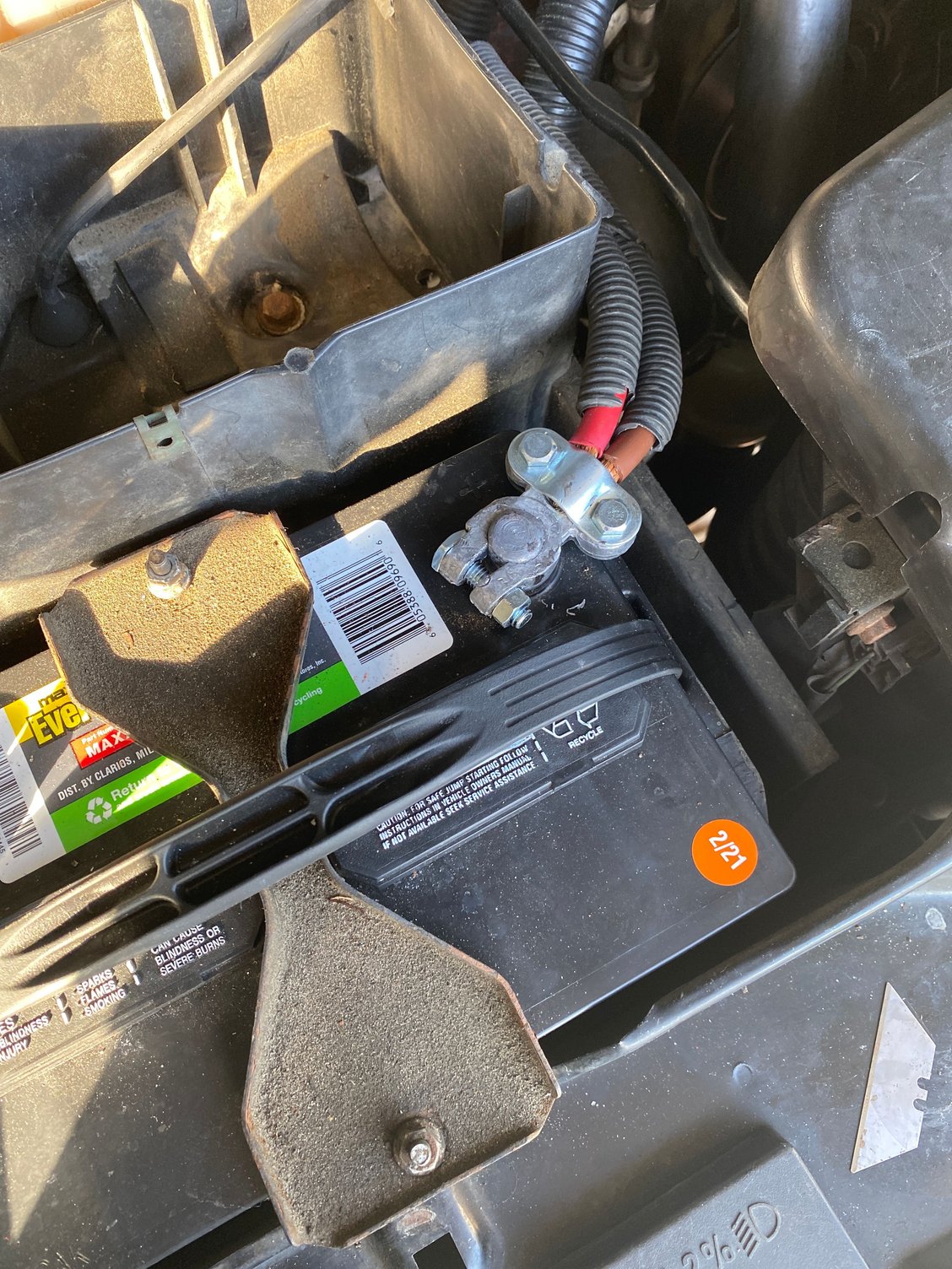

Well after many attempts to clean the factory connectors to the positive side of the battery it became apparent that the cable ends were corroded. I replaced with a parts store connector. I was extremely skeptical that this would work. Well to my surprise IT WORKS!!!! I’ve only driven about 20 miles since the repair but still don’t have service engine light on.
