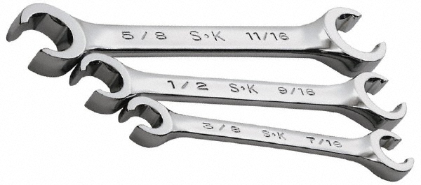

ah hell, sorry about that. let us know what you find. 15 minutes of tinkering should provide some results...like he was saying about the Crow-foot wrench.
