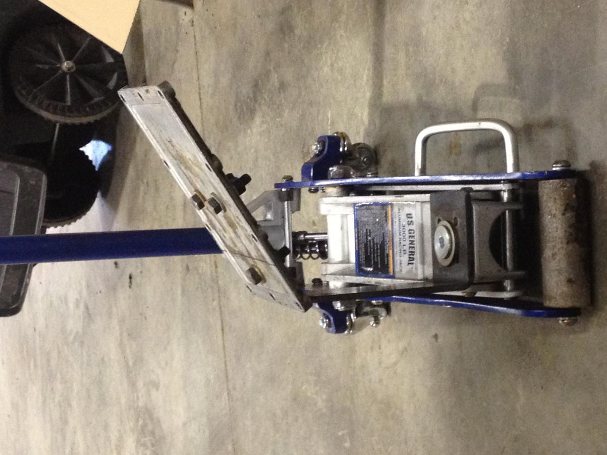

Its Not as much a bitch since you know where everything is, but can be a pain. You need to make up some kind of adapter to sit it right on your jack to get up there, otherwise you'll never get it lined up. The rave manul gives you some specs to build one, and just tweak for your jack and how high you need it. Here's what I did, used the inspection cover from my old case and made up an adapter for my jack to hold where rave said and it worked perfectly, case on there it stood on its own even jacked up, made install a breeze.
Sorry for the rotated pic, it's straight in my phone, forum rotated it lol
